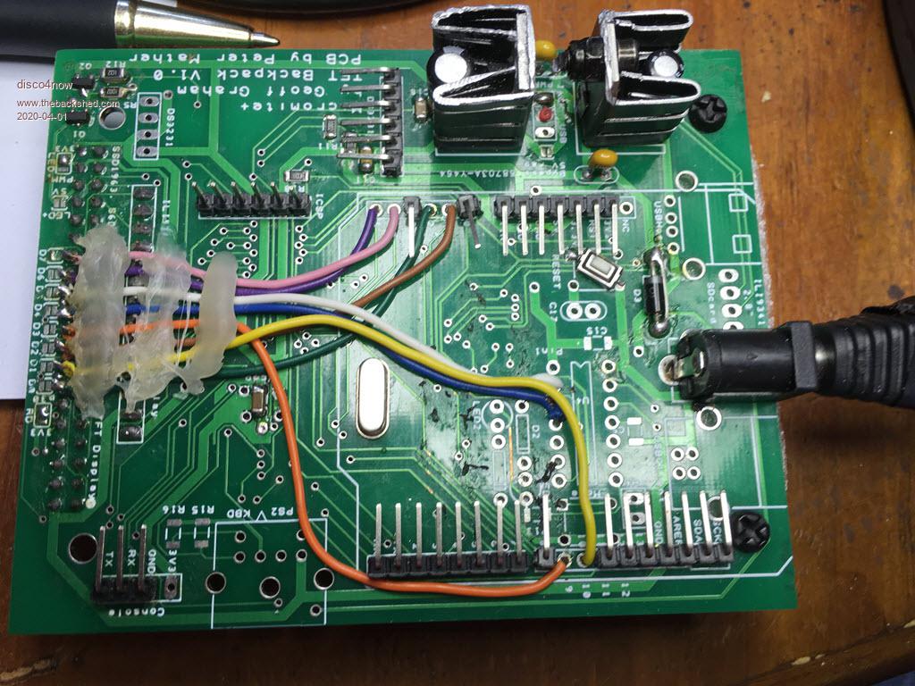

I have a matherp 470Backpack PCB with the 2x20 pin SSD1963 style LCD interface. I would like to try an ILI9341 3.2" LCD in 16 bit mode on that platform but can not find any 16bit drivers (or CFunction) - found an 8 bit CFunction but I would like to use the LCD in its default 16bit mode.
Can anyone point me to a 16 bit driver/CFunction for the ILI9341 3.2" LCD please?
Thanks,

I have one I wrote some time ago. I ran extra wires on  peters M70 backpack as shown below.
This shows the pins I used for B8-B15
#ifdef MX470
Option->LCD_Reset=28;
p[0]=60;
p[1]=61;
p[2]=62;
p[3]=63;
p[4]=64;
p[5]=1;
p[6]=2;
p[7]=3;
p[8]=14;
p[9]=13;
p[10]=12;
p[11]=11;
p[12]=17;
p[13]=18;
p[14]=21;
p[15]=22;
I will post it up if this is what you are doing. I have this board setup to get any P16 LCD working first before I try to configure as 8 bit.
Most can be converted to 8 bit with a bit of hacking. See this thread.
8 bit conversion
Gerry

Gerry,
I decided to go the 8 bit route initially before modifying the matherp backpack.
To that end, I moved the resister on the display as indicated and I have downloaded your 8bit CFunction.
Can you outline the sequence of loading and initialising this driver (I have loaded the ILI9341_p8 CFunction into the MM+ but am unsure as what do do to enable it and have it functional)
Thanks,

Hi Doug,
Put it in the mm.startup sub, create it if you don't have one.
You may have to set the RD pin high.
Also I think pin 54 is used to control the backlight on peters board, so setting it high might  be required as well.
sub mm.startup
   ILI9341_P8(1)          '8 bit ILI9341 in landscape
'   SETPIN 55 ,DOUT    'RD PIN
'   PIN(55)=1
'   SETPIN 54 ,DOUT    'F_CS PIN
'   PIN(54)=1
end sub
I have recompiled the driver to include the following addition required in later
MMbasic. Have not tested but will if you have problems.
V1.01 2020-04-01 Added DisplayType=20 required by later software.
Gerry

panky
Joined: 02/10/2012
Posts: 1135
Posted: 11:52pm 03 Apr 2020
Hi Gerry,
Good news and bad news - display worked with the new software until I managed to short out some pins and let the smoke out! Unless I can repair, I will need to order a new display
Thanks for all your assistance,
Doug.
