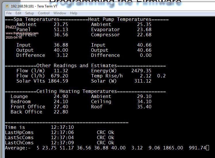

Hi All,
Bit of a quiz, to see what answers I get, now that I think I've solved it...
Story,
My Coms monitor, GCMicro2 (64) has been stable forever despite a bit of screen flicker when the ESP8266 or HC-12 hit it up for some transmit power.
I just never misses a beat & polls my Spa Controller, Heat Pump & Ceiling heat controller.
Does up a nice VT-100 page for me to see in Teraterm, & also sends the data to two E-100's to display on their screens.
So all of a sudden it's randomly crashing out to the prompt.
Can run for hours before this happens & can't see the issue in teraterm, as it's done an idle disconnect from the ESP8266 when I randomly discover it.
I had added a few lines of code before the issues apeared, but did check their operation & that code worked fine.
  Quote  if FlowRate > 1 then
Print Str$((37-TmpScCur)/(FlowRate*60*(TmpScOut-TmpScInp)/1000),3,1)
Else
print "   "
End If
Print "    Solar Vlts "; STR$(SlrVlt,4,2);"        Solar (W)     "; Str$(SlrWat,4,2)
I just wanted a number on the console output to give me a ball park time in hours as to when the water would be up to temp; save the mental calc based on the "Temp Rise/h", 2.12 in the above image.
Avoided a Div by Zero with the IF statement.
All works Ok in both the Pump running & idle state when Flowrate is zero.
Checked & wiggled hardware; rechecked the code above; watched it sit running on the floor on the laptop, but was at a loss why it behave & then when not watching it stopped.
Anyone wan't to put up their theory on why it might have been crashing out?
See if we come up with the same answer?
Phil.

I've fixed it now, but all the detail pointing to the problem is in the post above,
I just would like to challenge everyone to spot the fail point; the one I overlooked so many times.
I even caught it crash in Teraterm before my eyes today, and it was exactly what I finally realized earlier.
Only the first 5 of the 6 lines posted above were new code, & the answer is in that new code.
It's pretty damn simple, but admittedly I missed it time & time again.

TmpScOut-TmpScInp could equal zero ? giving divide by zero

  disco4now said  TmpScOut-TmpScInp could equal zero ? giving divide by zero
Lol, Lock it in?
I missed that possibility repeatedly. Then the Penny dropped.
Whilst digging thru the ((((('s & )))))'s, thinking order of operations.
You win the Beer!
