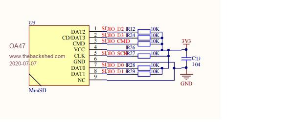

Posted: 09:24am 07 Jul 2020
More help needed with the SD card on the F4. The random failure of the Sd card has become frequent enough to be annoying. I have tried new cards, delays in program around the SD card code and none have really improved the situation. I am using PE2, PE3, PE4, PE5, PE6, PC13, PC0, PC1, PC2, PC3, PA0, PA1, PA2, PA3, PC4, PB0 pins for monitoring and I cannot see any conflicts with the Sd card pins. Each of the pins are held high by an external 10K resistor and are pulled low by opto-coupler outputs. What I have found is that if I disconnect the ribbon cable to the opto outputs and pullups the program always boots without the "SD CARD not present error" and I can re-connect the cable while the program is running and I dont get any further errors until a re-boot. I have ordered replacement F4 boards a couple of months ago to verify that there is not a fault on the board I am using but they are still to arrive. At the moment I have run out of ideas and would like any comment from fellow shedders.

SD comms using SDIO seems much more susceptible to noise than SPI which is why I've stuck with SPI on the CMM2 even though it is slower. The pullups on the board are probably 10K which is higher than ST recommend. You could try replacing these with 47K. I haven't got the circuit diagram to hand but also make sure there isn't a pullup on the clock line

According to the CCt diagram all pullups on the SD card are 10K and there is one shown on the CLk line.

Start by removing the pullup on the clock line and see if that helps

Joined: 11/04/2012
Posts: 1054
Posted: 02:48am 09 Jul 2020
Peter you were right on the money.
Lifted R27 (SDIO SCK Pullup 10K) and have not been able to get the error to appear.
Thank you, Thank you, Thank you
