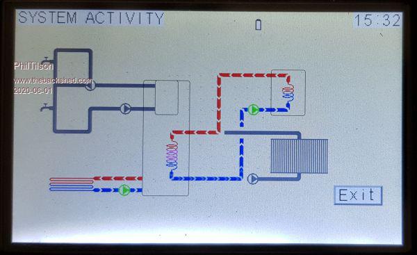

I am using a MM+ as a central heating controller.  From the 'main menu' screen I can select a number of options - setting up the DHW, setting up the CH and a 'mimic' display (of which I actually posted details on here many months ago!).
My problem is this: I use the PAGE facility to set up different sets of controls for the different functions.  As I switch from menu to menu I load different pages and this all works perfectly, except...
When I load the mimic diagram for the first time, I get the 'Exit' button, and the various hotspots on the screen work as intended - clicking on a pump turns it on or off etc.  Clicking on the Exit button returns me to the main menu.  However, when I next go to the mimic screen, there is no Exit button and no hotspots on the screen, and I don't understand why this should work the first time but not subsequently.

As is so often the case, having set out the problem clearly, in order to obtain advice, the solution then appears!
For the benefit of those who may have been interested, the problem occurred when exiting the mimic page. To clear the screen prior to writing back the main menu, I used the CLS command.  It would seem that using this command actually deletes the GUI controls on the screen, and they cannot be resurrected by simply using the PAGE command.  I must admit, I do find this a little odd (or am I misunderstanding something?)
Problem solved by removing the CLS command and instead writing over the diagram with spaces.  (The original diagram is created using a custom font of the various symbols and lines.)
Posts: 3368
Posted: 09:32pm 31 May 2020
The CLS command hides any GUI controls (it doesn't delete them).  That way they are removed from the screen but not lost.  You can restore them using GUI SHOW.
