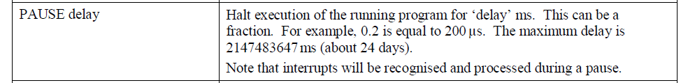

I am trying to find out the minimum supported PAUSE time, specifically for a MM2 running at 40MHz. The manual shows:
As a value of 0.2 is used as an example of a fractional PAUSE time, presumably 200 uSec is achievable, but how far lower than that can a MM2 handle?

It is a bit of a meaningless question. You could specify a pause time of 1uS and the processor would do that but the time taken to interpret and parse the command would be significantly longer
If we assume the MM2 executes 25,000 simple Basic instructions a second then a hypothetical PAUSE 0 would take 40uSec to process
On the CMM2 at 270,000 Basic instructions per second the same PAUSE 0 would take just under 4uSec

at the other end of the scale... i suspect the maximum delay (2147483647ms, approx 24 days) may be outdated, as it predates the move to 64-bit integers. 292,271,023 years is likely the true upper limit.
is anyone able to test this?
