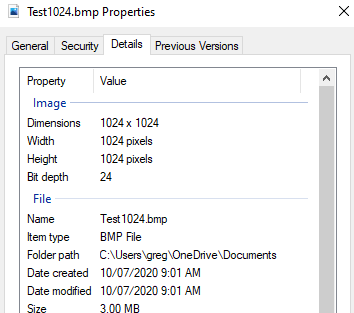

Hi Peter. It's probably just me doing something dumb, but my CMM2 is feezing when running your example code above.
I've cut back the code to isolate when this happens:
option console serial
framebuffer create 1024,1024
page write framebuffer
load bmp "Test1024" 'load a 1024x1024 image to the framebuffer
framebuffer backup 'back up the image
memory
mode 4,16
print mm.hres
print mm.vres
i=0
for j=0 to 1023-mm.vres
print j,;
framebuffer window i,j,0
next j
Here's my console output at the freeze point:
Flash:
  1K ( 1%) Program (16 lines)
515K (99%) Free
RAM:
  0K ( 0%) 0 Variables
2048K (39%) General
3136K (61%) Free
480
432
0       1       2       3       4       5       6       7       8       9       10      11      12   13      14      15      16      17      18      19      20      21      22      23      24      25   26      27      28      29      30      31      32      33      34      35      36      37      38   39      40      41      42      43      44      45      46      47      48      49      50      51   52      53      54      55      56      57      58      59      60      61      62      63      64   65      66      67      68      69      70      71      72      73      74      75      76      77   78      79      80      81
ie. The CMM2 freezes / the framebuffer command never returns, when j hit's 81.
Observation: 1024 - mm.vres - 80 == 512.
(Not that that may have any relevance? LOL)
Only other observation is that when I retain the diagonal line, the bottom of the last image displayed (at j=80) appears to be the very bottom of the 1024px high image (ie. where the diagonal line meets the bottom right corner).
This is kinda unexpected as the j loop at this point should be displaying a 432px high window at an offset only 81px from the top of the image?
I'm sure someone will point out if I'm just doing something dumb?
Edit:  For reference, here is my 1024px image properties:

Posts: 11974
Posted: 07:19am 10 Jul 2020
  Quote  Hi Peter. It's probably just me doing something dumb, but my CMM2 is feezing when running your example code above.
No: its me being dumb. When I cut and pasted the listing I missed the top line
MODE 2,16
As a result the framebuffer was created in 8-bit mode and only half as big as it needed to be. I'll try and trap this and generate an error in the firmware rather than locking up. Sorry for your time wasted
GregZone
Joined: 22/05/2020
Posts: 114
Posted: 08:08am 10 Jul 2020
  matherp said  When I cut and pasted the listing I missed the top line
MODE 2,16
Thanks Peter. Yes, it does make some sense that the allocation would be based on the current / intended colour depth.  That didn't occur to me.
When you say you missed the top line "MODE 2,16", I assume this could also have been "MODE 4,16"?
ie. You just need to ensure that the intended colour depth is in place before the framebuffer create?
Would it not have been possible to store a framebuffer attribute, which specified it's created colour depth? This would then allow the the "framebuffer window" command to determine if colour depth matched the current mode, or even (if possible) to allow an on the fly conversion?
ps. No time wasted. Just good to know it wasn't a bug, as such.
