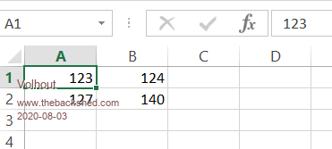

BTW - If I was a good bit cleverer and a lot more confident, I'd write a programme to read in and write out CSV files, so I can move data between Excel and PC-MMB. If anyone has done this already, I'd appreciate a copy.

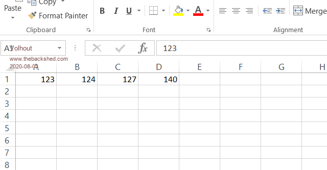

Hi IanT,
It is very simple to create csv files from MMbasic for DOS.
You have to write data in readable ASCII form, with comma's in between.
Example
Open "test.csv" For output As #1
a = 123
b = 124
c = 127
d = 140
Print #1, Str$(a);",";Str$(b);",";Str$(c);",";Str$(d)
Close #1
End
In Windows you will see a file named "test.csv" appear.
Clicking on it will open Excel
If you want the data in different rows, you have to use different print statements
a = 123
b = 124
c = 127
d = 140
Print #1, Str$(c);",";Str$(d)
Close #1
End
The file opens up as:
Edited 2020-08-03 19:27 by Volhout
