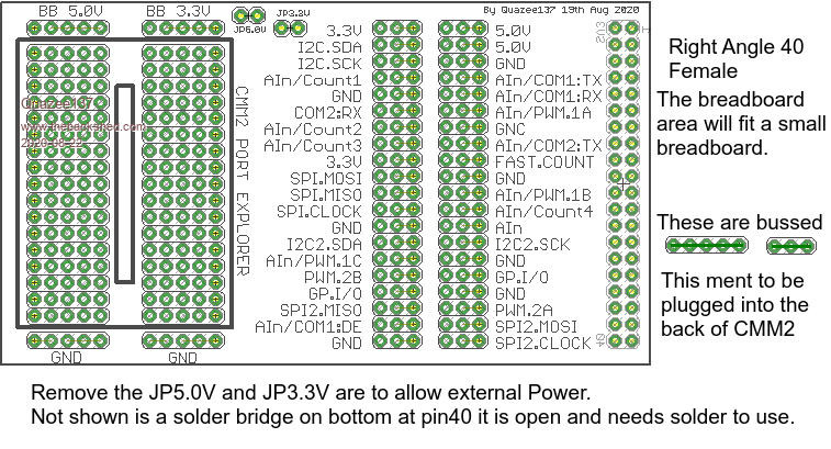

If this is wanted I'll get boards made and get the RA 40 pin female.
 It is based off a prototype I made for a friend just starting out with
 the MM170BP. I have ordered pcb's for the MM170 version for a group of
 kids.

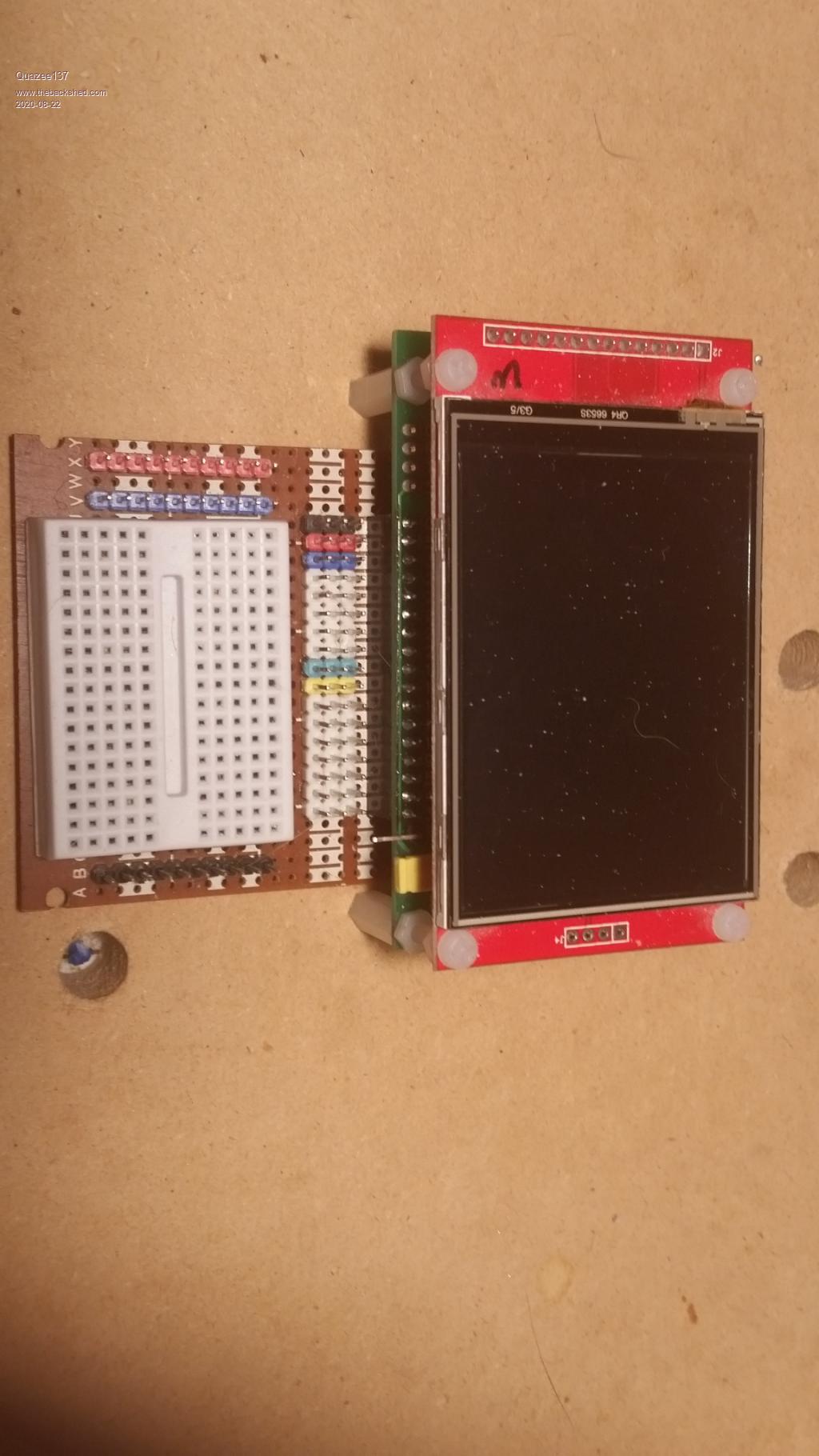

 and the prototype of the MM170BP version.

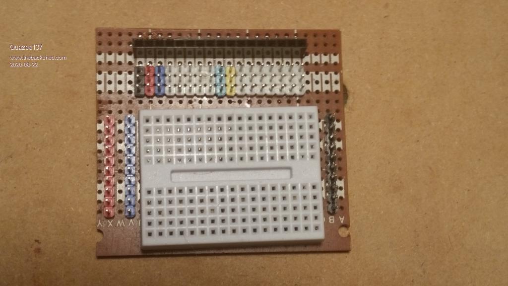

in use.
The 5.0V is red, 3.3V is blue, GND is black I2C Data is green, I2C Clock is yellow.
