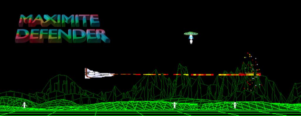

Well, for better or for worse, here's my first program for the Maximite. Defender. To be honest it just started out as me playing around (up until yesterday the file was still called "test.bas"). I don't claim that it's well programmed, it was very much just me screwing around. I knew I wanted to play with parallax scrolling, and before I knew it I had a passable defender clone (a testament to the CMM2's ease of use - not my programming prowess). Buoyed by encouragement from the Maximite Facebook Page guys, I'm publishing it here - warts and all. I did go through and comment some of the code - but it was really a great learning experience for me.
The main thing I learned was that the first line I should have typed was "option explicit". I was having a great old time using undefined variables with gay abandon like an absolute maniac, however that came back to bite me during debugging. I will also plan my sprite/bitmap management better next time.
Next time I will also impose a proper naming convention. I started using the one I use for C/C#, but quickly realised that it didn't fit, so then I tried another convention and finally a third. I would argue by the time you have three different naming conventions in the one program.... you technically do not have any naming convention.
I also need to learn how to do proper sound effects (this one just has simple waves), but like I say it was never intended for public publishing - just for me to learn.
But for all of that, it's here. I hope you enjoy it.
I'm going to move on from it, I feel this code has done it's job for me, which is to highlight the mistakes I made, and also teach me what "I don't know" yet.
To that end, I'm going to program another tech demo next, and use it to fill in the massive blanks in my knowledge.
Once that is done, then hopefully I'll be ready to start writing a "proper" game. One that I won't be ashamed to show you guys the source code for :-D
The Defender source code can be downloaded from here,

Here you go.
https://youtu.be/jgUyCZoqWgA
Unfortunately my camera didn't pick up the sound, but you're not missing much there - it's definitely the weak spot of the game.

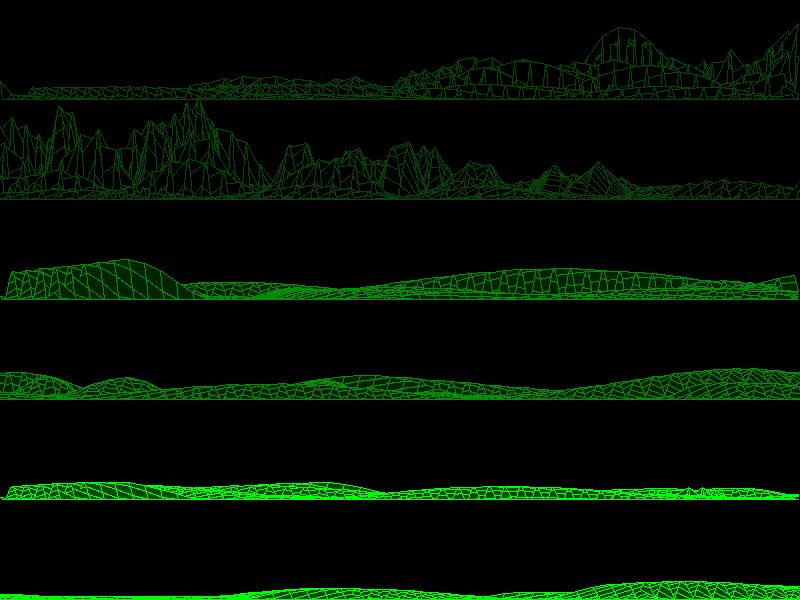

I was really trying to get a good parallax going. I am very happy with the way the vertical parallax looks. It kicks in when the player is in the top half of the screen, I wanted to give the impression of rising up high over the mountains.
The player has three lives and I originally had it so that the game paused and restarted for a few seconds after each death, but this slowed down the game play. So I made it that the screen flashes each time the player collides with something, and on the third hit they explode. That caused issues if the player ran through a bunch of aliens and lost all three lives straight away, so the player now gets a 3 second shield of invulnerability each time they lose a life.
The 3 mountain ranges are drawn on one buffer screen. Each range is 1600 pixels wide and 100 pixels high. So mountain range 1 is on rows 0-100 and 101-200. Range 2 is on 201 to 300 and 301 to 400. And range 3 is on 401 to 500 and 501 to 600.
These are blitted on to the screen and stitched together to repeat indefinitely.
I drew the mountains in the program using a sin/cosine calculation - the type you would use for a 3d plot. And instead of drawing it in 3d, I plotted it sideways on. This took about 20 seconds during startup, so once I was happy with them I saved the bitmap to disk and removed the code (so now it just loads the screen on startup). If you noticed I plotted the mountains at different brightnesses to help with the depth illusion (further away = duller colours). I also plotted the foreground mountains with filled in polgons (filled with a dark green) so that they would do "hidden line removal" on the mountains ranges behind them.
Finally, for the 3d effect of the ground I again wrote a little plot function that would draw a 3D grid at 20 evenly spaced angles, and then depending on where the player is on the X-axis, I plot the appropriate one of these 20 steps, which gives the effect of the 3d scrolling ground.
I know it's hard to see with all of the images stuck together, so it might be clearer if I show a couple of them split out.
If I can answer any other questions, I would be more than happy to. Thank you for all of the positive feedback. It is appreciated.
P.S. Despite the video, I can actually play the game better than that, but I was balancing the keyboard on one knee while peering around the back of the camera :-D

Would you mind posting the code you used to draw the mountains and the ground?  I would love to see that!!

As promised, here's the code to draw the mountains, and the code to draw the foreground scroll.
DrawBackground.zip
Here are the relevant code modules. The first one is for the mountains
mode 1,8
cls
dim float height(100,100)
dim integer xarray (3)
dim integer yarray (3)
page write 0
DrawMountains(1)
DrawMountains(2)
DrawMountains(3)
sub DrawMountains(formula)
 ' Calculate the grid of values
 for x=-50 to 50
   for y=-50 to 50
     distance = sqr(x*x+y*y)
     distance2 = sqr ((X-10) * (x-10) + (y-10) * (y-10))
     distance3 = sqr(abs ((x+22) * (x+12) + (y+11) * (y+3)))
     if formula=1 then height(x+50, y+50) =cos(distance2/3) * sin(distance/4)* sin(distance3) * (50-distance)* 2.4
     if formula=2 then height(x+50, y+50) = sin(distance2/10) * cos(distance/4) * cos(distance3/2) * (30-distance)*1.6
     if formula=3 then height(x+50, y+50) = sin(x/10) * cos(distance/4) * cos(distance3/2) * (30-distance)*0.8
     if height(x+50,y+50)<1 then height (x+50, y+50)=1
     'Make the last height equal to the first so that it is seamless
     if x=50 then height(x+50,y+50) = height(0,y+50)
   next y
 next x
 ' Plot each rectangle as a filled polygon
 for x=1 to 100
   for y=1 to 100
     ' Is this the second (wrapped) line?
     tempx = GetOnScreenX(x,y)
     yoffset=(formula-1)*200
     xoffset=0
     if (tempx>799) then
       xoffset=-800
       yoffset=(formula-1)*200 + 100
     end if
     xarray(0)=GetOnScreenX(x-1,y-1) + xoffset
     yarray(0)=GetOnScreenY(x-1, y-1) + yoffset
     xarray(1)=GetOnScreenX(x,y-1) + xoffset
     yarray(1)=GetOnScreenY(x,y-1) + yoffset
     xarray(2)=GetOnscreenX(x,y) + xoffset
     yarray(2)=GetOnScreenY(x,y) + yoffset
     xarray(3)=GetOnScreenX(x-1,y) + xoffset
     yarray(3)=GetOnScreenY(x-1,y) + yoffset
     r = abs(height(x,y))*6
     if r>255 then r=255
     if (formula=1) then polygon 4, xarray(), yarray(), RGB(0,80,0), RGB(0,0,0)
     if (formula=2) then polygon 4, xarray(), yarray(), RGB(0,128,0), RGB(0,40,0)
     if (formula=3) then polygon 4, xarray(), yarray(), RGB(0,255,0), RGB(0,80,0)
   next y
 next x
end sub
function GetOnscreenX (x,y)
 GetOnScreenX = y*2 + (x*16)
 rem if GetOnscreenx > 800 then GetOnscreenX = GetOnScreenX-800
end function
function GetOnScreenY (x,y)
 rem GetOnScreenY = 500 - (y*2) - height(x,y)
 GetOnScreenY = 100 - height(x,y)
 rem if GetOnScreenX(x,y) > 800 then GetOncreenY = GetOnScreenY + 200
end function
and for the foreground/ground level
mode 1,8
cls
for animation=1 to 20
 yoffset= 200+(animation-1)*10
 line 0,yoffset,800,yoffset,1,rgb(0,255,0)
 line 0,yoffset+4, 800, yoffset+4,1,rgb(0,255,0)
 line 0,yoffset+9, 800, yoffset+9,1,rgb(0,255,0)
 for verticals = 1 to 10
   xoffset = animation*4
   x1 = xoffset+ (80*verticals)
   x2 = 400 + ((x1-400)*1.2)
   line x1,yoffset, x2, yoffset+9,1,rgb(0,255,0)
 next verticals
next animation
