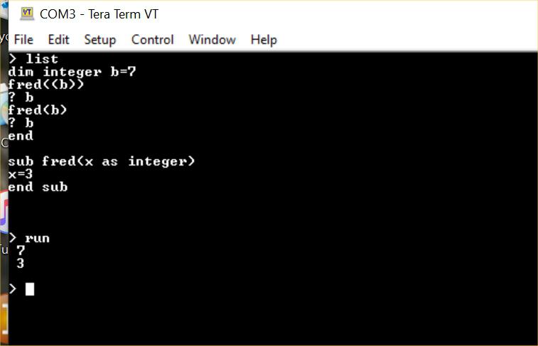

If you want to pass a variable by value and be certain it won't get altered in a function or subroutine just enclose it in brackets in the calling sequence. This forces the interpreter to create a temporary variable in order to evaluate the contents of the bracket and it is then the temporary variable that is passed.

  matherp said  If you want to pass a variable by value and be certain it won't get altered in a function or subroutine just enclose it in brackets in the calling sequence. This forces the interpreter to create a temporary variable in order to evaluate the contents of the bracket and it is then the temporary variable that is passed.
So - this works a treat.
Options:  Defining a local variable in the function is more verbose but obvious
         Passing ((x)) is "easier" but less transparent.
In teaching this to kids -- I think the more verbose way is clearer....
Is either way more "efficient" as far as the interpreter is concerned?

That makes more sense than passing "x+0" or "x*1"

  zeitfest said  [ warning - killjoy mode ]
I think that should invoke a variable called 7...yada yada yada...and exasperate users...
hmm, in almost no programming languages (and of course not in mathematics).
