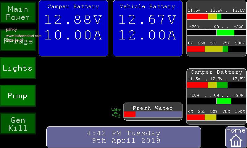

It is certainly possible. I have loaded Annex Basic into an ESP8266 and run a program on a Maximite Plus.
The Maximite+ monitors a number of switches and controls relays in a camper trailer. It connects to the ESP8266 via serial and the Annex basic program in the ESP8266 'remotes' the switches. These can then be operated by my smartphone using wifi.
sw_9.zip
The image above is a sample of the MM+ display (which is hidden in an outside accessible panel      ) - I use the 8266 to remote the controls inside the camper trailer so I can controls things from bed using my phone!.
sw_9.zip includes the Annex Basic code for the 8266. Annex Basic is pretty easy to use as it is very similar to MMBasic. To link the two, you just need to determine a data exchange protocol (mine is very simplistic) and run it over a serial link.

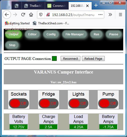

Web interface created by ANNex Basic

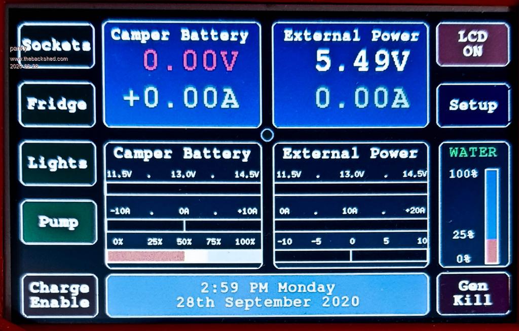

MMBasic lcd display (updated from previous but SAVE IMAGE decided not
to work for me so quality is ordinary).
The MMBasic program is running on a custom MM+ board that has relays and current sensors. Display is a 5" LCD. The Annex Basic is running on a WiMOS D1. The 2 are linked via COM1.
Doug.

Doug--thanks very much. Great stuff--really fine-looking screens.

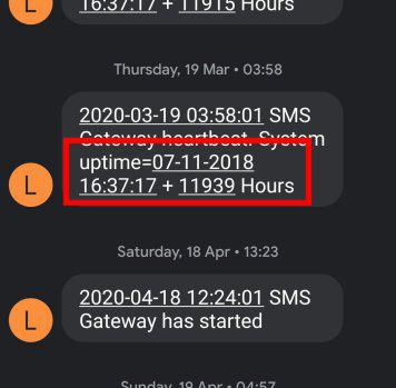

  JoOngle said
Not sure, I've got tons of 8266's (all variants even), but they seem to suffer from a "latchup" after running for some time, and require some resetting.
honestly not had a problem. this system has an uptime of 1.3 years(!) until I had to tweak the code and it started again. MM2 5.0408, ESP8266+M590 GSM module

6. The HTML scripts in the 8266 act as a web server - they are accessed by any browser, doesn't matter what platform. There is no additional code or apps needed on the device you access the 8266 via WiFi. That is, it can be phone ,tablet, PC, MAC etc. The 8266 has embedded Javascript code to link the HTML that your browser is acting on with Annex BASIC in the 8266. This in turn interacts with the serially connected MM.
A couple of further notes/caveats:
- the Annex BASIC web interface does not like Chrome as the browser - in the edit mode it gets lost from time to time as to which line you are editing. Firefox works fine.
- you will need to have a reasonable knowledge of HTML and CSS to understand what is happening re the switches - see here for a full description as well as learning examples ( it took me some months to fully??? understand how the 2 interact with Annex BASIC).

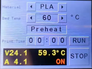

  MikeO said  Sometimes the code involved to make a user interface can be a larger effort than the actual code for the project.
So true. I built a heated bed controller for my 3D printer - it spent months running as a "terminal application" because I just couldn't face the aggro of a custom screen. It took me a month of pondering to come up with this
.. but I am fairly happy with it. It's moved into a daily user state so... a few wrinkles but mainly with the underlying operation. Provides all the functionality I need in an almost "finger operable" touch display.
I always aim for that Windows95/CE look. I have developed a few routines that make it easy(er) but I plan to do a grid based system when I get time, which should make it all really easy (the code to parse the touches and equate to a button is a pain).
Edited 2020-10-01 19:09 by CaptainBoing
