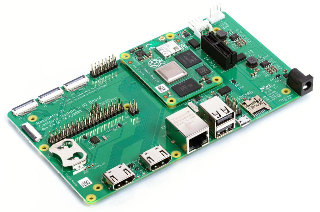

Posts: 2552
Posted: 12:22pm 20 Oct 2020
with 8gb RAM, wireless, no onboard EMMC, the price is us$75. add to this $35 for the I/O expander brings the total to us$110 (+cost of an SD card). basically this is a small motherboard with full-sized connectors  for everything, onboard RTC, and a PCIe x1 slot. all powered from 12v:
https://www.raspberrypi.org/products/compute-module-4-io-board/
(image from: https://www.raspberrypi.org/app/uploads/2020/10/Module-and-IO-Board-2_-scaled.jpg
this suddenly makes the RPi4 a much more interesting device as a viable intel-PC alternative
rob   :-)

mclout999
Joined: 05/07/2020
Posts: 524
Posted: 12:35pm 20 Oct 2020
The one drawback is that there are NO USB3 ports.  And that is a deal-breaker for some.  You can add PCIe x1 card but to me, that seems bass-ackwards.
Posts: 2552
Posted: 01:13pm 20 Oct 2020
reading through the documentation, it seems that on the standard RPi4 the PICe port is used to implement the two USB3 ports using a PICe to USB3 bridge, "The PCIe link on the Raspberry Pi 4, Model B is used for the USB  3.0 interface via the VLI805 XHCI  controller. If the application requires USB 3.0 interface then an external XHCI controller is required like the VLI805.". from:
https://datasheets.raspberrypi.org/cm4io/cm4io-datasheet.pdf
found here:
incidentally, the I/O expander contains a 4 port USB2 hub: two ports you can see on the edge of the board, a header nearby brings out the other two.
hopefully someone will come up with a cheap custom PCIe x1 expander card that implements USB3 as well as a few SATA ports. or, the plans to the I/O expander are open-source, so anyone could roll their own.
