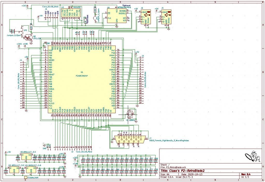

If Propellor basic can be loaded into the Parallax would it not be possible to port MM over to it to load directly into it?
  Quote  Eric Smith, has created a native compiler called FastSpin that understands Spin 1, PASM (P1), BASIC, C, and is now supporting Spin 2 and P2ASM. Many programmers use Eric’s compiler to get more speed from their existing Spin programs.
For those who prefer C, Eric also has you covered with the advantage of being able to mix code from other languages. For example, I wrote a test program in C for the P1 that used several of my Spin 1 object libraries. Like Peter, Eric is very helpful with forum members, and always seems keen to incorporate good ideas and suggestions provided by those using his compiler.
One of the first C compilers for the P1 was Catalina by Ross Higson. It has been updated for the P2, and as with the other tools, that development (especially libraries) continues. Ross puts together a nice installation package that provides a version of Code::Blocks that is ready to produce Propeller code. This simplifies getting started for new programmers.
For those who love BASIC, I already mentioned that FastSpin understands a dialect of BASIC, and recent forum posts suggest that Terry Hitt is porting his popular PropBASIC to the P2.
Quoted from here
Finally, if you’re a Python programmer, you’ll be happy to know that microPython runs on the P2. This is very exciting given the multi-core approach of the P2. Hopefully, the folks at Adafruit will make a port of their CircuitPython (derived from microPython) available for the P2 as well. Python is becoming very important in education, and having it run on small micros is beneficial for students who have an interest in embedded design and coding.
It c an output VGA directly so maybe it can do HDMI as well, or at least the SSD and other displays we mostly use
this is the circuit of the single chip computer
Edited 2020-11-08 19:40 by lew247
