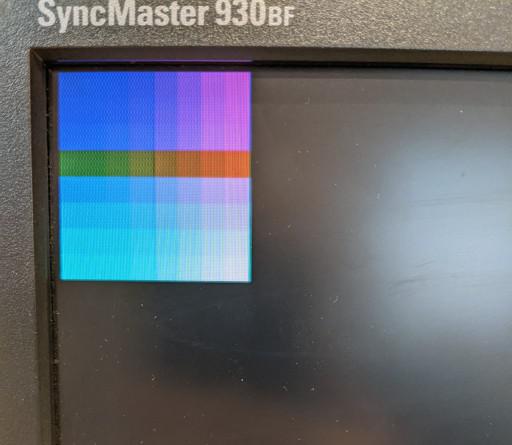

Hi all,
I've written a bit of code that draws the red, green colour range in 8 bit colour mode with blue set to 185, as follows:
mode 1,8
for y=0 to 7
 for x=0 to 7
   red=x*36.428
   green=y*36.428
     box x*10,y*10,10,10,0,0,rgb(red,green,185)
 next x
next y
I'm getting a weird off-colour bar at y=3 (green=109) that looks like the blue value goes to zero (see screenshot below).
Note it only does this in 8-bit mode. If I switch to 16-bit mode, it displays perfectly. I'm guessing it's something to do with the default 8-bit colour mapping/translation?
It does this on RC18 and RC19, I've not tried it on any earlier releases.
I thought I'd better report it here.

Same on my Dell screen  - only tried your mode 8 code.

Day 1 typo/bug that no-one has picked up before - thanks - will fix in next release

I remembered the first video about the CMM2 https://www.youtube.com/watch?v=lzrX72aB7zg&t=2s and at 8:45 it talks about the nature of the circuitry of the VGA DAC showing that the GREEN channel was 6bit as apposed to RED and BlUE that are only 5bit.  He noticed the pattern of colors when he was testing the palet.  Is that the issue here?

Problem colourbar all fixed in RC21.
