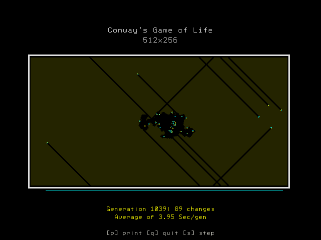

I've been stewing over how to make my CMM2 Game of Life faster, even after reading Michael Abrash's wonderful Graphics Programming Black Book, and finally figured out a way to do so.
Here's the zip file; it contains FASTERLIFE.BAS and NICE_CURSOR.SPR.
FasterLife.zip
I welcome any suggestions, in particular those having to do with features in recent iterations of the firmware (coming so fast and furious it's hard to keep up).  I'm still figuring out page write, sprite, and blit timing interdependencies, hence the (perhaps) excess number of PAGE WRITE directives before graphics output.
Thanks!
- Steve "NPHighview" Johnson
