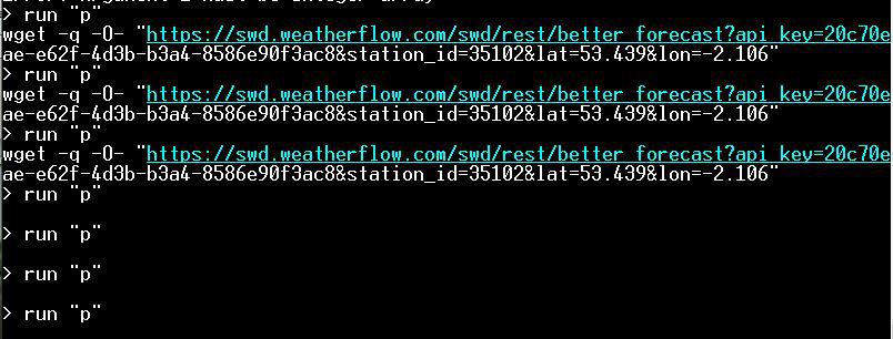

This is my program
Dim As integer e(15000)
DIM STRING q=Chr$(34) '" symbol
system "wget -q -O- "+q$+"https://swd.weatherflow.com/swd/rest/better_forecast?api_key=20c70eae-e62f-4d3b-b3a4-8586e90f3ac8&station_id=35102&lat=53.439&lon=-2.106"+q$,e()
day$=JSON$(e(),"daily[1]day_start_local[2].month_num")'day_num
PRINT day$
I have tried every way I can think of to get the JSON parsed so I get the result I want
this is what I have tried
  Quote  day$=JSON$(e(),"daily.day_start_local[2].day_num")'day_num
day$=JSON$(e(),"dailyday_start_local[2].day_num")'day_num
day$=JSON$(e(),"day_start_local[2].day_num")'day_num
day$=JSON$(e(),"daily.day_start_local[2]month_num")'day_num
day$=JSON$(e(),"daily.day_start_local[2].month_num")'day_num
As you can see I changed the day_num to month_num to check it wasn't something to do with that field
This is the results
I want to get the relevant data from the DAILY section of the JSON
This is PART of the JSON return from my call
If you want to see the complete return click HERE
  Quote  {"latitude":53.439,"longitude":-2.106,"timezone":"Europe/London","timezone_offset_minutes":0,"current_conditions":{"conditions":"Clear","icon":"cc-clear-day","air_temperature":0.0,"sea_level_pressure":1028.0,"relative_humidity":96,"wind_avg":0.0,"wind_direction":15,"wind_direction_cardinal":"NNE","wind_direction_icon":"wind-rose-nne","wind_gust":0.0,"uv":0,"feels_like":0.0,"includes_station_data":false},"forecast":{"daily":[{"day_start_local":1606780800,"day_num":1,"month_num":12,"conditions":"Partly Cloudy","icon":"partly-cloudy-day","sunrise":1606723218,"sunset":1606751644,"air_temp_high":6.0,"air_temp_low":0.0,"air_temp_high_color":"0053ee","air_temp_low_color":"0000e1","precip_probability":10,"precip_icon":"chance-sleet","precip_type":"sleet"},{"day_start_local":1606867200,"day_num":2,"month_num":12,"conditions":"Rain Likely","icon":"rainy","sunrise":1606809707,"sunset":1606838000,"air_temp_high":7.0,"air_temp_low":3.0,"air_temp_high_color":"006ae4","air_temp_low_color":"001ee1","precip_probability":80,"precip_icon":"chance-rain","precip_type":"rain"},{"day_start_local":1606953600,"day_num":3,"month_num":12,"conditions":"Rain Likely","icon":"rainy","sunrise":1606896193,"sunset":1606924360,"air_temp_high":4.0,"air_temp_low":2.0,"air_temp_high_color":"003bf2","air_temp_low_color":"001ee1","precip_probability":60,"precip_icon":"chance-rain","precip_type":"rain"},{"day_start_local":1607040000,"day_num":4,"month_num":12,"conditions":"Snow Likely","icon":"snow","sunrise":1606982677,"sunset":1607010724,"air_temp_high":3.0,"air_temp_low":1.0,"air_temp_high_color":"001ee1","air_temp_low_color":"0000e1","precip_probability":70,"precip_icon":"chance-snow","precip_type":"snow"},{"day_start_local":1607126400,"day_num":5,"month_num":12,"conditions":"Rain Likely","icon":"rainy","sunrise":1607069159,"sunset":1607097091,"air_temp_high":4.0,"air_temp_low":3.0,"air_temp_high_color":"003bf2","air_temp_low_color":"001ee1","precip_probability":70,"precip_icon":"chance-rain","precip_type":"rain"},{"day_start_local":1607212800,"day_num":6,"month_num":12,"conditions":"Wintry Mix Possible","icon":"possibly-sleet-day","sunrise":1607155639,"sunset":1607183461,"air_temp_high":5.0,"air_temp_low":2.0,"air_temp_high_color":"003bf2","air_temp_low_color":"001ee1","precip_probability":40,"precip_icon":"chance-sleet","precip_type":"sleet"},{"day_start_local":1607299200,"day_num":7,"month_num":12,"conditions":"Wintry Mix Possible","icon":"possibly-sleet-day","sunrise":1607242116,"sunset":1607269835,"air_temp_high":4.0,"air_temp_low":3.0,"air_temp_high_color":"003bf2","air_temp_low_color":"001ee1","precip_probability":40,"precip_icon":"chance-sleet","precip_type":"sleet"},{"day_start_local":1607385600,"day_num":8,"month_num":12,"conditions":"Rain Likely","icon":"rainy","sunrise":1607328591,"sunset":1607356212,"air_temp_high":5.0,"air_temp_low":3.0,"air_temp_high_color":"003bf2","air_temp_low_color":"001ee1","precip_probability":50,"precip_icon":"chance-rain","precip_type":"rain"},{"day_start_local":1607472000,"day_num":9,"month_num":12,"conditions":"Wintry Mix Possible","icon":"possibly-sleet-day","sunrise":1607415064,"sunset":1607442593,"air_temp_high":5.0,"air_temp_low":3.0,"air_temp_high_color":"003bf2","air_temp_low_color":"001ee1","precip_probability":40,"precip_icon":"chance-sleet","precip_type":"sleet"},{"day_start_local":1607558400,"day_num":10,"month_num":12,"conditions":"Rain Likely","icon":"rainy","sunrise":1607501534,"sunset":1607528977,"air_temp_high":6.0,"air_temp_low":3.0,"air_temp_high_color":"0053ee","air_temp_low_color":"001ee1","precip_probability":50,"precip_icon":"chance-rain","precip_type":"rain"}],"hourly":[{[/QUOTE}

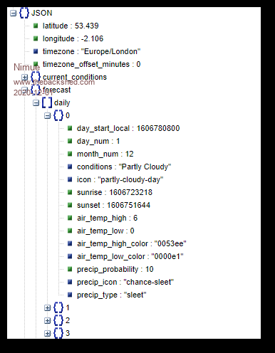

Hi
I always start with JSON by viewing it in: http://jsonviewer.stack.hu/  >> in the text tab.
View the structure in the View tab.
What I see is that the structure is:
forecast >> daily >> day (with 10 elements - one for each day)
Is this as simple as you need to also include the forecast element in your query and then retrieve the data?
The data for each day is in >>>
forecast.daily[0]  << will return all the data in daily {0}
But I have to admit, I would only ever access JSON via Python (dont hate me)
Nim
(edit for spelling)
Edited 2020-12-01 19:36 by Nimue
Nimue
Joined: 06/08/2020
Posts: 449
Posted: 09:55am 01 Dec 2020
....  So, for example:
import json
from urllib.request import urlopen
weather = urlopen('https://swd.weatherflow.com/swd/rest/better_forecast?api_key=20c70eae-e62f-4d3b-b3a4-8586e90f3ac8&station_id=35102&lat=53.439&lon=-2.106')
wjson = weather.read()
wjdata = json.loads(wjson)
print (wjdata['forecast']['daily'][0]['day_start_local'])
Will print "1606780800"  >>> which is the forecast.daily[0].day_start_local element data...
So in your case, do you need:
day$=JSON$(e(),"forecast.daily[0].day_start_local")'  << would be equivalent, but not quite sure on the format you need for your parser.
Importantly, the day$ string you are creating will only contain the single element you are retrieving (in this case day_start_local).
To retrieve all the element data, day$=JSON$(e(),"forecast.daily[0]")'  << would now contain all the elements for daily[0], but would need further parsing to extract each element.

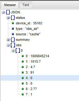

This is what the JSON of THIS LINK returns
I can't figure out how to get the obs array in a string using JSON
a$ = JSON$(e(),"obs") should have worked according to the manual
or possibly
a$ JSON$(a%(), "obs.0")
Neither works
I did try JSON$(e%() as well as JSON$(e()
Anyone who knows JSON know the answer why it isn't working?

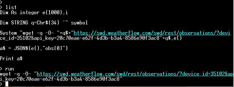

I have trouble making sense of this, and can't test, but does this not work?
a$ = JSON$(e(),"obs[0]")
Returning the entire string contents, "1606847855,1015.5,4.7,93,0,0,2.77,1" of the zeroth element of the obs array?
Likewise would a$ = JSON$(e(),"obs[0][0]") return "1606847855".

I'm trying to Return the  entire string contents, "1606847855,1015.5,4.7,93,0,0,2.77,1" as you thought
because once I can do that I can figure out how to get it to return each field as part of the JSON return

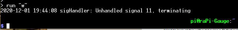

Unfortunately a$ = JSON$(e(),"obs[0]")
returned
and
a$ = JSON$(e(),"obs[0][0]") crashed MM
Edited 2020-12-02 05:50 by lew247

  Quote  ? JSON$(e(),"obs[0][0]") 'crashes
? JSON$(e(),"obs[0]") 'crashes
? JSON$(e(),"obs") 'crashes
? JSON$(a(),"obs.0") 'crashes
? JSON$(a(),"obs.1") 'crashes
I'm guessing it's one of the Pi-Cromite bugs that never got fixed.
The disadvantages of PI being the only Micromite that has WI-FI
Edited 2020-12-02 19:06 by lew247

It looks like the JSON implementation does not handle an array of arrays
so you need to pull out the required string by finding the text between
[[ and ]].
Then use FIELD$ to pull the data from the bit pulled out.
See code below.
(I think we have discovered this before)
