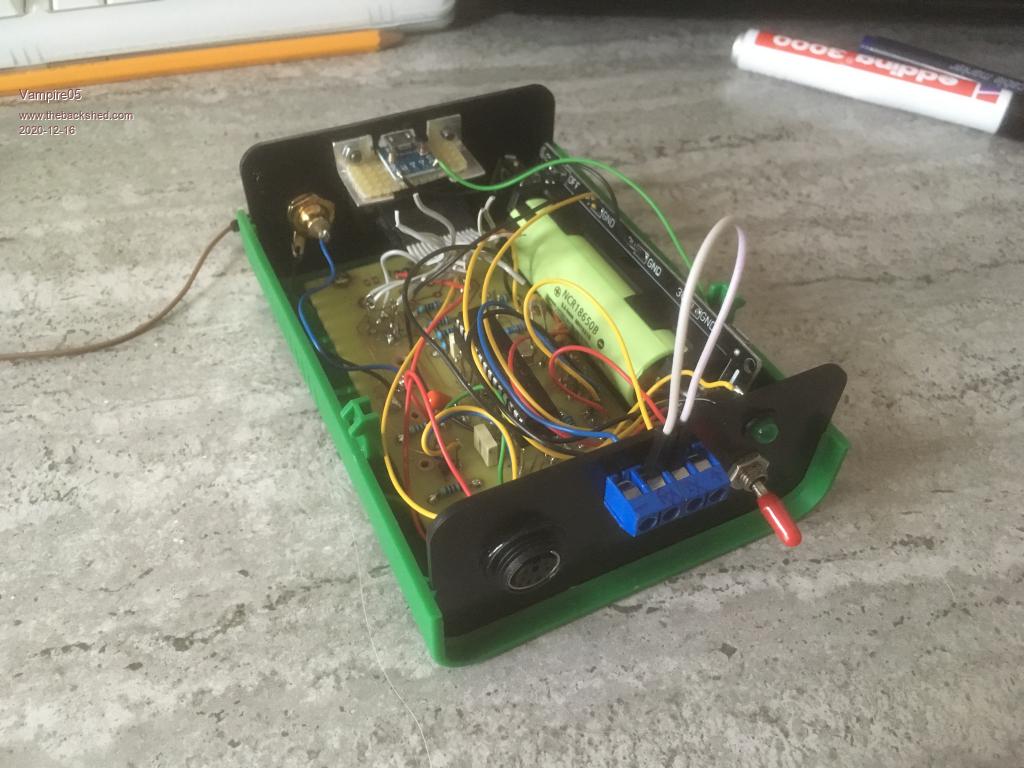

Hi guys,

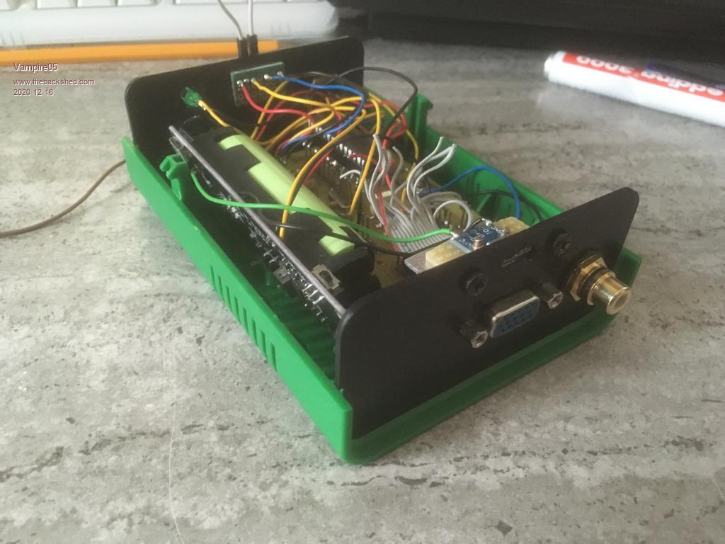

i need your ideas. I can not get a video signal out from my ascii terminal (vt100 emulator):
Instead of the MCP1700-330 i used the Wemos ESP32 18650 Battery Shield.
For VGA, i only connected the green signal (Pin 2) and soldered the "green" pad in the "select color" section on the pcb. I have checked connection from PIC to VGA Output-> everytbhing is fine! I testet 3 VGA Monitors but no visible Output. Same on Composite Output!
If i turn the device on, the activity led is on. On every keypress of the ps2 Keyboard the led is blinking. So i think the input part works fine.
Any Ideas of whats going on with the Video Output?
The Schematic:

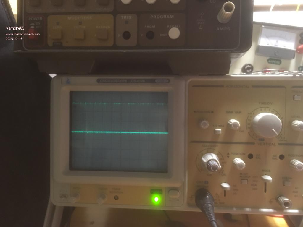

When you are testing the terminal make sure that you place a jumper across the Tx and Rx pins.  That way anything you type will be echoed back and you can then see the result of your typing on the screen.
If that does not work you should try an oscilloscope on pin 12 of the PIC32.  Do you see anything?

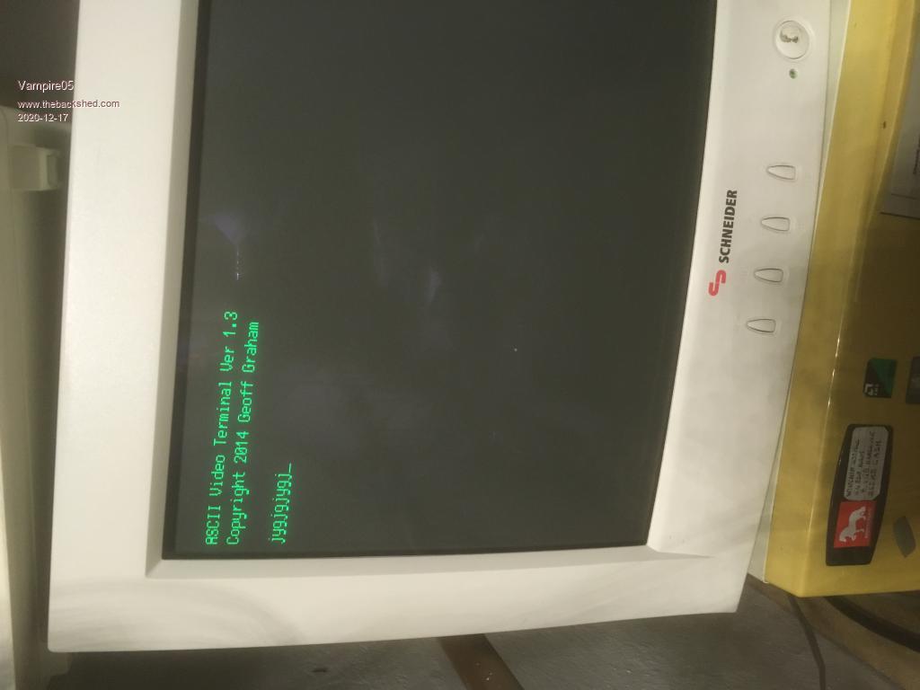

yes i connected RX with TX with the jumper cable on the frontpanel (second picture).

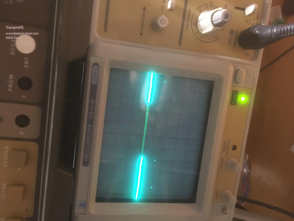

Pin 12 on the oscilloscope:

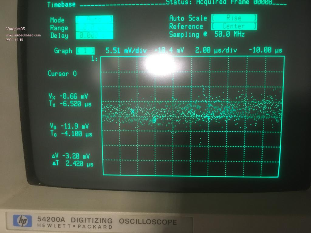

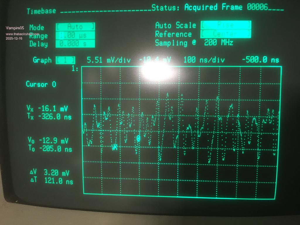

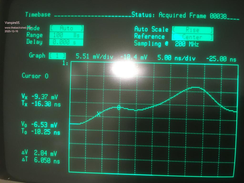

Here is Pin 12 with different oscilloscope timings:

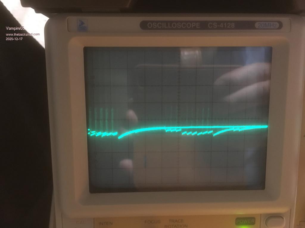

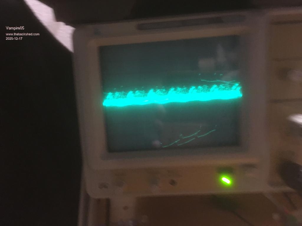

VSync:
Hsync:
Green channel

You have activity on all the required VGA signal lines and you can be sure that the firmware is generating the correct signals... so the fault must be in either:
- Your wiring to the VGA connector
- Your VGA cable
- Your monitor
You need to check all three VERY carefully.

it works now! Thank you very much Geoff!
The Problem was a missing Connection between Pin 18 and Pin 25 on the self eached PCB. This is the reason why VGA AND Composite does not work. The HSYNC is used by both signals! Now both works.
