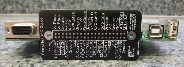

Hi , if iam not totally wrong i think the cmm2 Pin number are mirrored. Because the Port has a Pin 1 sign But the manual Says its pin number 40.

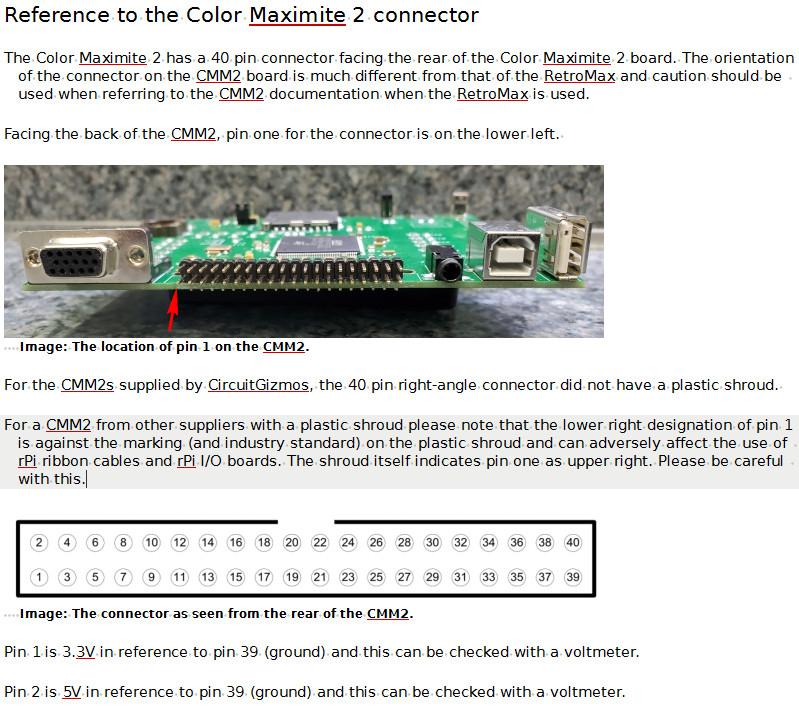

Turbo46
Joined: 24/12/2017
Posts: 1694
Posted: 08:16pm 19 Dec 2020
Is this what you are talking about?
  The Manual page 10 said  These numbers are used as reference in the table below and by MMBasic to refer to an I/O pin.
They are not the connector manufacturer’s standard pin numbers.
Bill
CircuitGizmos
Joined: 08/09/2011
Posts: 1427
Posted: 09:02pm 19 Dec 2020
The image in my RetroMax documentation has a red arrow pointing to pin 1.
CircuitGizmos
Joined: 08/09/2011
Posts: 1427
Posted: 09:41pm 19 Dec 2020
The RetroMax I/O guide in the back of a CMM2:
Plasmamac
Joined: 31/01/2019
Posts: 620
Posted: 05:59am 20 Dec 2020
RTFM ! Sry
