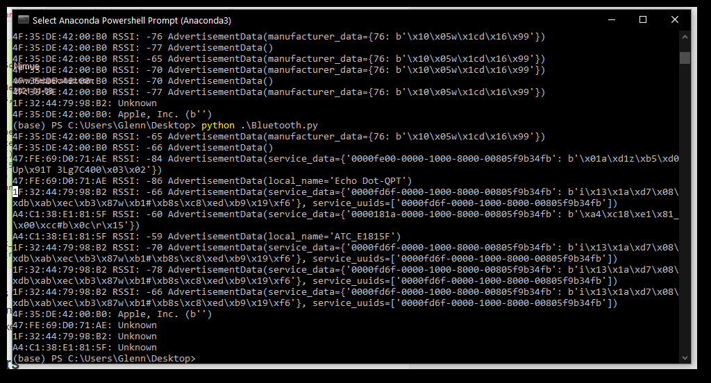

Nimue
Joined: 06/08/2020
Posts: 419
Posted: 11:06am 08 Jan 2021
Some progress....
The "Bleak" library :  https://bleak.readthedocs.io/en/latest/scanning.html works for reading the advertised bluetooth data...  with one caveat..... not under Anaconda / Jupyter notebooks.
So, under Windows 10 with the above libraries, I am able to "see" the sensior:
In the screenshot, the device is "ATC_E1815F" and the next couple of lines is the packet info for the data being sent.
Need to "park" this and do some paying work for a bit....
Nim

Output:
  Quote  MAC address: a4c1382865be
18:13:27   23.9`C  52%  79%  2.919V
18:13:48   23.9`C  52%  79%  2.919V
This is with the standard ESP32 firmware and module firmware from the first post.
