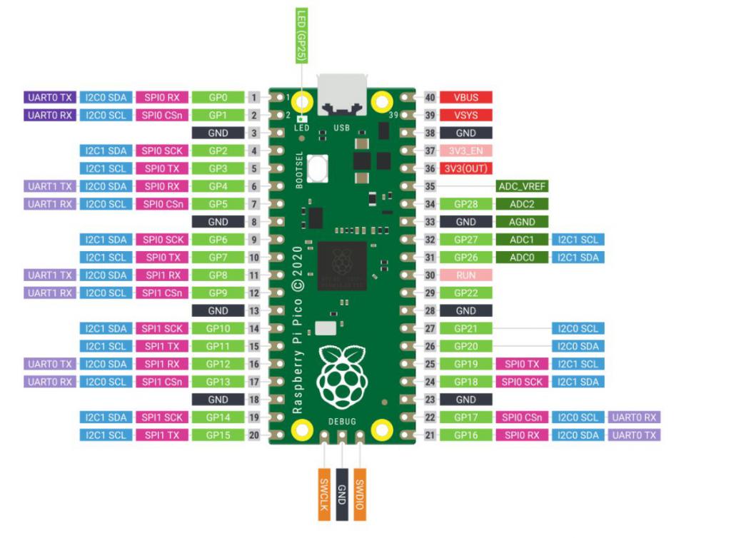

taken from here
In many ways, the Pico is a well-appointed microcontroller board.
It has 26 3.3 V GPIOs, a standard ARM Serial Wire Debug (SWD) port, USB host or device capabilities, two UARTs, two I2Cs, two SPIs, and 16 PWM channels in eight groups.
RP2040 has a dual-core Cortex M0+ with luxurious amounts of SRAM 2MB of flash, USB connectivity, and nice power management
