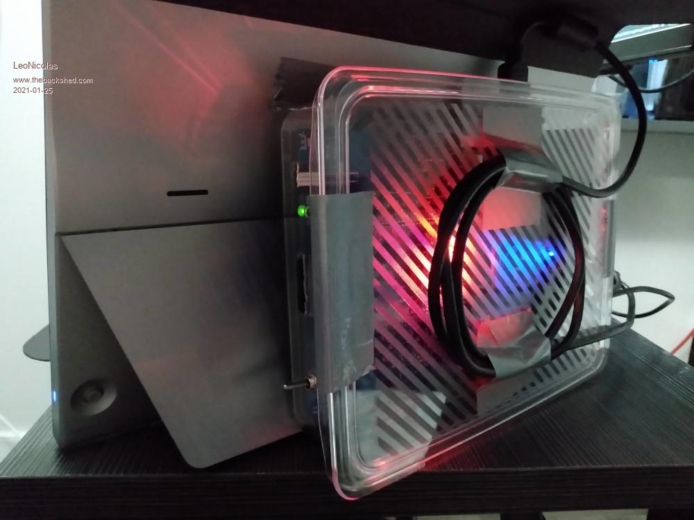

Is it a portable CMM2? Yes, it is

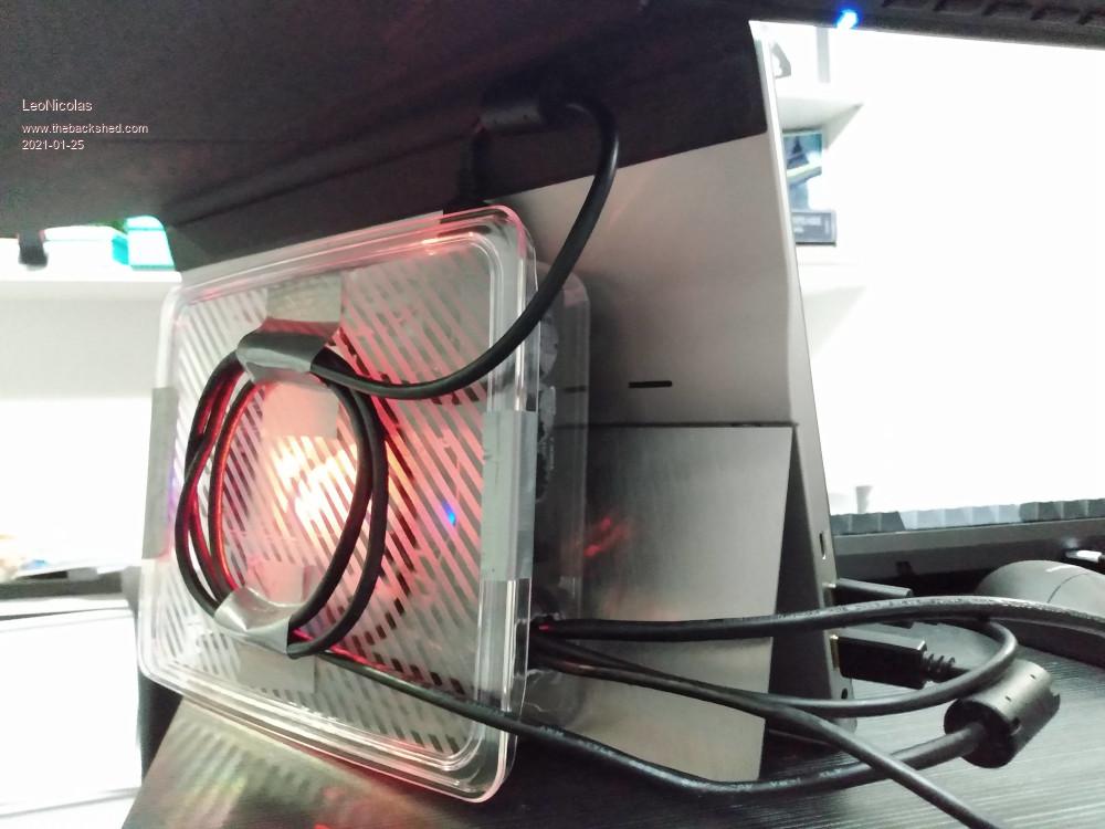

I put my CMM2 inside a box with a VGA HDMI converter and an USB Hub and I fixed it behind a portable 15" monitor.
Now I only have to connect 2 cables to play with my CMM2. The keyboard and the USB power cable.
The next step is to replace the duct tape for a better solution. Maybe something 3D printed.

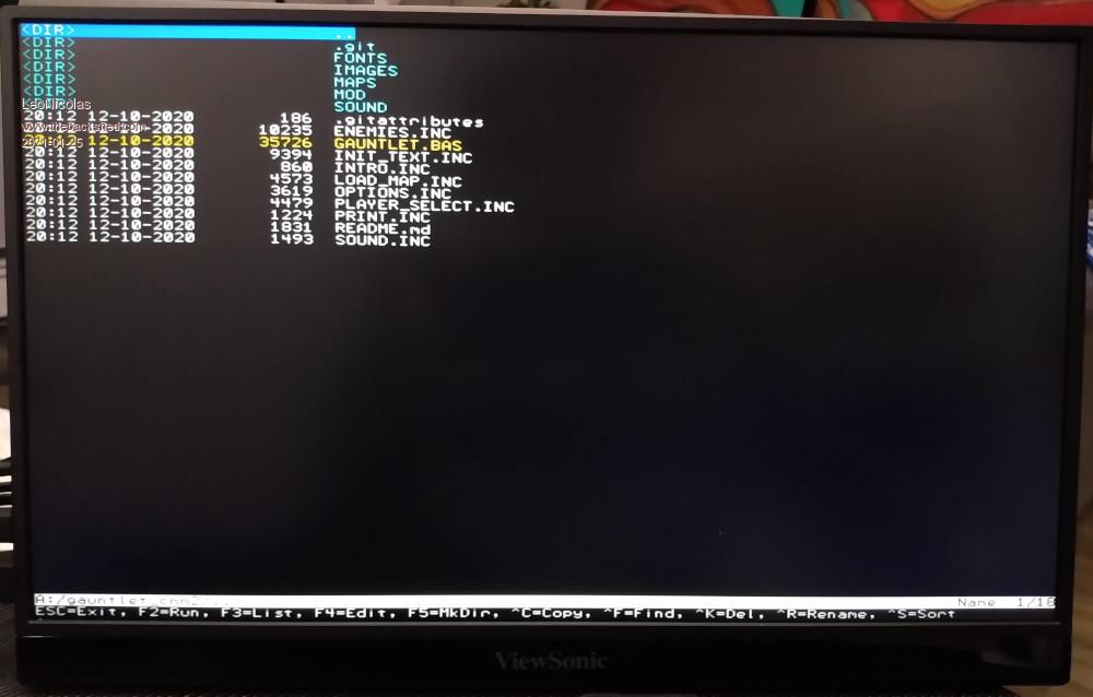

It's a ViewSonic 15.6 inch portable monitor model VG1655
The USB hub is being used for distribute power to the monitor, CMM2 and the VGA to HDMI adapter. It should be a good USB hub to support all devices power consumption. I'm using a Unitek 4-Ports USB 3.0 model Y-3089A.
The VGA to HDMI adapter is a Cable Matters VGA to HDMI model 103070-black
