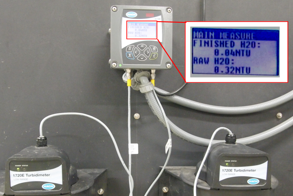

last word, that pic on WikiP for a potable water filter shows the following in/out NTU. (big boys toys Turbidimeter 1720E - yours  for a cool 300 sovs)
