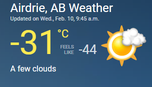

Posted: 05:01pm 10 Feb 2021
Fantastic! I wish I had time to enter!
My CMM2 is sitting on my desk taunting me - I am desperate to get back to playing with it, but Covid downturn has left me working long hours trying to keep my business afloat
I am keeping an eye on this forum though - and I am seriously going to have to re-read the new manual when things get back to normal. So many amazing and exciting changes to tinker with!
Good luck all. Now, if someone could write me a program that controls the weather, I would be very appreciative.
