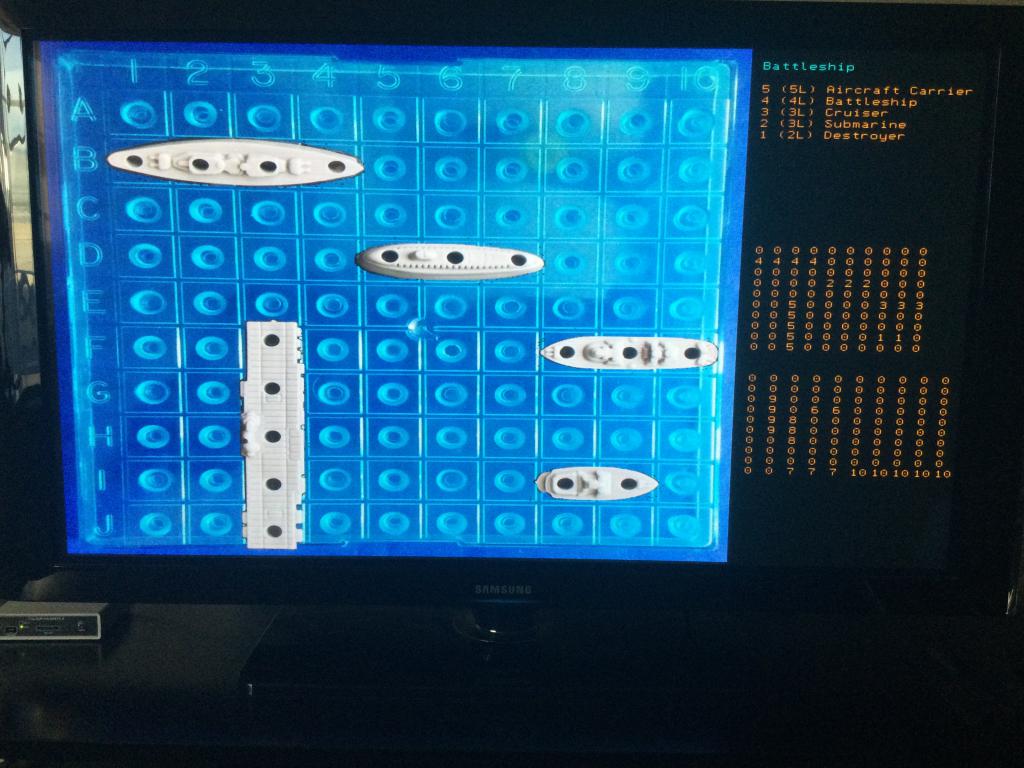

Why does using PAGE COPY 1 TO 0, B, 1 work with a blank screen,
but does not work when put on top of a PNG file?
One can put a PNG file on top of another, but the black pixels are displayed.

Don't know your specific issue, but "rgb(black)" is transparent. To make a near-enough black, use rgb(notblack).

  lizby said  on't know your specific issue, but "rgb(black)" is transparent. To make a near-enough black, use rgb(notblack).
Discovered that using BLIT with optional orientation parameter value &B100 does what I was looking to accomplish, namely not show black pixels.  Note that I am using mode 9, 16.
Posts: 11982
Posted: 10:37pm 23 Feb 2021
That screen looks great
