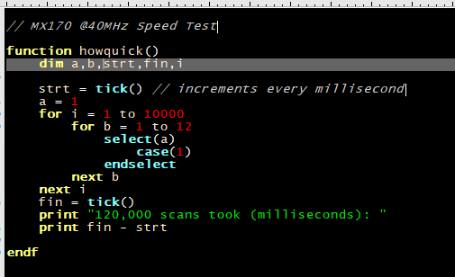

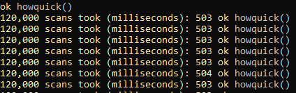

For when MMBasic won't cut it:
Edited 2021-03-08 01:12 by Tinine
Posts: 11882
Posted: 03:15pm 07 Mar 2021
The code as written appears to only ever action case 12

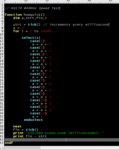

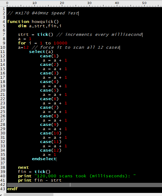

  matherp said  The code as written appears to only ever action case 12
If you see the REM, I force it to scan all 12 cases. If I let it action all cases, it's about 2ms quicker:
But now it's not 120,000 scans, obviously.

Posts: 11882
Posted: 03:36pm 07 Mar 2021
Still not convinced. Every basic normally executes just one CASE and has an implied break.
The first version does 10000 loops of one case and the second seems to do the same given that it executes at the same speed
What happens if you put a second loop?
for i=1 to 10000
for a=1 to 12
select.....
next a
next i
PS. Its is a great shame bypic don't post their source as they don't support it anymore. It would really fly if ported to one of the faster chips
Edited 2021-03-08 01:39 by matherp
Tinine
Joined: 30/03/2016
Posts: 1646
Posted: 04:01pm 07 Mar 2021
In the first example, it's all scanning and no variable incrementing. In the second example, it's less scanning but a variable is being incremented.
I have ByPic for the MX370 @80MHz and 512K flash but I love the DIP 170 and I still have 130K+ flash.
Edited 2021-03-08 02:01 by Tinine
Tinine
Joined: 30/03/2016
Posts: 1646
Posted: 04:13pm 07 Mar 2021
Paid a penalty for the extra for/next. The inline code is very fast but any sort of a loop incurs a time penalty.
