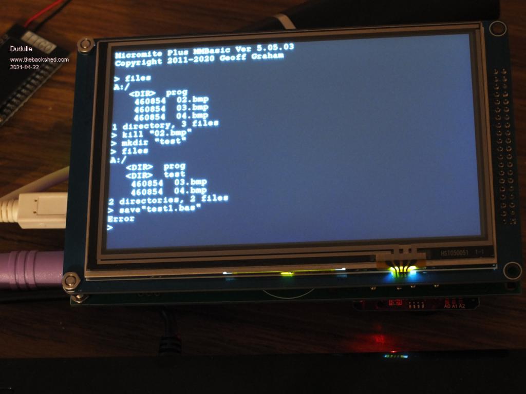

Hello everyone
I have a new probleme ; I can't save any program on SD card with save command (save "test.bas" ). The micromite just respond "error"
But I can make a directory, or delete a file (with kill command).
Drive command is not working on micromite, like on duinomite ?
Edited 2021-04-21 06:13 by Dudulle

Dudulle
Joined: 06/08/2012
Location: France
Posts: 21
Posted: 05:12pm 21 Apr 2021
Hi Geoff
First I would like to thank you for the great job you did, I am a huge fan of MMBASIC.
I made a picture of the screen (screenshot not working) to show the error message.
Posts: 10180
Posted: 05:24pm 21 Apr 2021
Looks like there is no space before the first "
Also do you have a program loaded? I don't know if MMBasic will save nothing

Posts: 3281
Posted: 01:01am 22 Apr 2021
This is getting stranger and stranger.  The way the error message function works there should always be a colon after the word Error followed by a message.  It looks as if the CPU is tripping up (that is a technical term!) while displaying the message.
It could be the SD card that is the problem.  A corrupted file allocation table can cause strange errors.  Could you please reformat the SD card on a PC and try again.  Also, trying a different SD card might provide a clue.
Geoff

Posts: 6264
Posted: 09:24pm 27 Apr 2021
You can create and delete directories so the SDcard 'write' seems to be working.
You would get a full error message if there was trouble writing to the card.
Try
SAVE IMAGE "test.bmp"
to see if you can save a screen image to the SD card.
Also please LIST the file you are trying to save.
If you have any non-ascii characters in it, that might be causing problems.

sorry for my messages, I found the solution by myself. I just had to type OPTION SDCARD 52,53 without 17
It was well explained but I had misunderstood...
