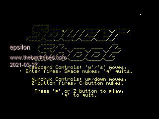

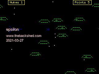

In an earlier post I mentioned that I came across a book by Mark Claypool about the development of a 2D Game Engine:
https://dragonfly.wpi.edu
I worked my way through the book and now have a by-the-book C++ 2D Game Engine. But may more interesting to TBS is that, as I went, I also created a roughly equivalent CMM2 MMBasic version (with a generous dollop of CSUBs). This was a great exercise: Not just learning about 2D Game Engines, but also mapping of C++ OO concepts to MMBasic was an interesting puzzle. Also interesting were the profiling based optimizations, absolutely necessary to squeeze a minimum of performance out of this engine.
Regarding performance, more optimizations are needed to make the engine work well with more than a handful of objects. However, I wanted to release a snapshot of the engine as it is now, now that it's still close to Mark Claypool's book. As I continue with optimizations and new features, the code base will only stray further from the original design.
Included in the code base is a little demo game using the game engine. Here's a potato quality video of me lasting a whole 5s in the game:
Video clip: https://youtu.be/3-vFXHYETiM
I don't really intend to support this code base in its current form. I just wanted to leave it here in case anybody's interested in Mark Claypool's book and wanted a CMM2 MMBasic version to cross-check against.

* SaucerShooter/ A demo mini-game used to demonstrate most of the features of the game engine.
SaucerShooter also serves as my benchmark for performance tuning:
 *ss_game: Starts the game
 *ss_game L: Starts the game and displays the game loop timing in the upper left corner.
 *ss_game F: Starts the game with frame rate limiting disabling and xProfiling enabled (ref. https://github.com/epsilon537/xprof_cmm2  for more info on xProf).
