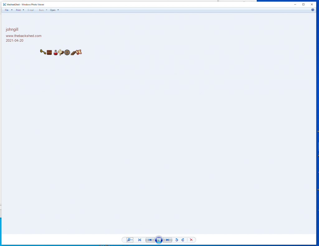

Hi all,
I'm trying to make a 640x400 png tilesheet for my game. I'm using corel Photopaint to export a 24 bit png with a transparent background, and it looks like this on the PC:
I've positioned 7 16x16 graphics in the top left hand corner of the sheet, and that's all it is.

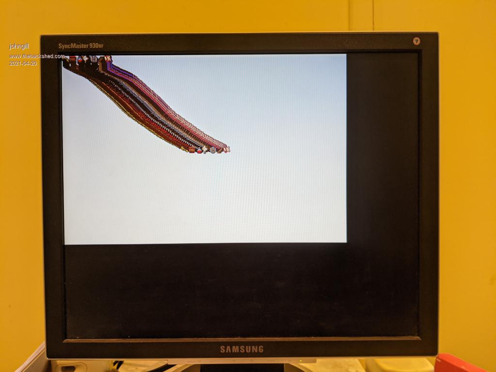

But when I load it up on my CMM2, it goes absolutely bananas:
no kidding - this is exactly the same .png file.
Have I done something dumb? Is photopaint somehow exporting the "transparentness" of the png in a weird way? What can I do to fix it?! Help!

Posts: 11982
Posted: 05:26pm 19 Apr 2021
If you post the png file (zip it up) then we can have a look

Posts: 11982
Posted: 06:56pm 19 Apr 2021
Don't know what the problem is but I've just saved as a png using a different program (Very old copy of PaintShopPro) and now it works. I assume corel is using some feature that isn't supported by the CMM2

I've loaded it up on my CMM2 as follows:
mode 8,12,rgb(80,80,80)
page write 3
load png "tilesheet2test.png"
page write 0
page copy 3 to 0
Sorry if it's just me being dim, but this doesn't seem to preserve the transparent background of the png - the black areas of the png are solid black rather than showing through to the rgb(80,80,80) background underneath...?
When I try opening the png up in photopaint, it shows the transparent background fine.
Any ideas???
Posts: 11982
Posted: 08:54am 20 Apr 2021
You need to specify the transparency cut off parameter
Try
load png "tilesheet2test.png",0,0,7
