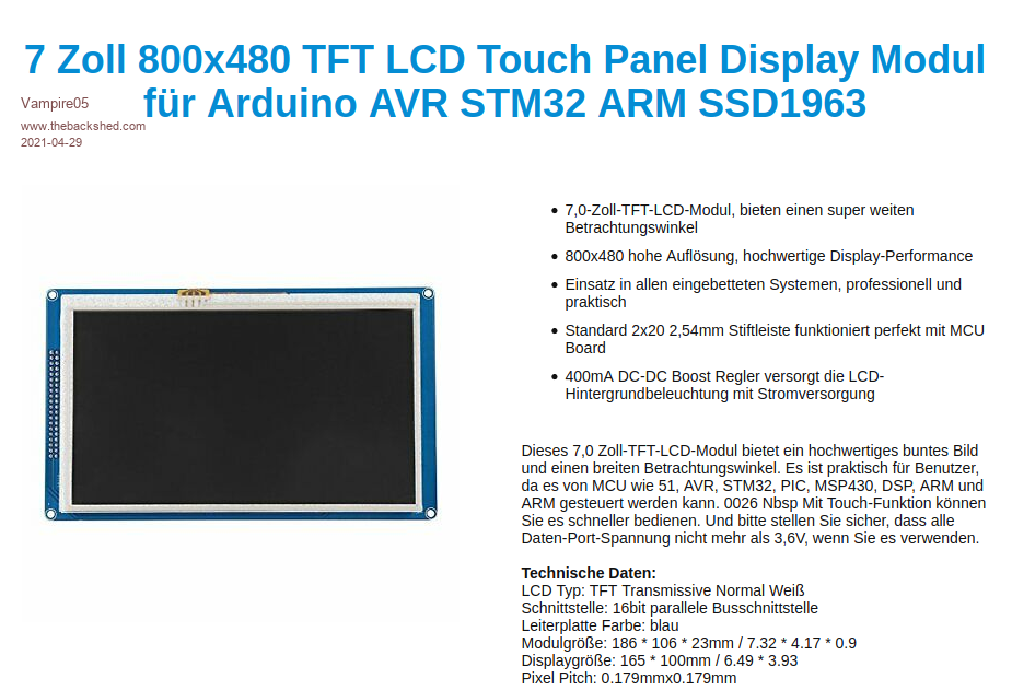

Hello People,
is this 7 inch Display 800x480 compatible with the Armmite F4 (STM32F407VET6):
it would be great to have one list with all Micromite Display Options
Best regards
Posts: 11741
Posted: 08:10am 29 Apr 2021
Yes
See my post here for details of how to wire and an adapter. Note you need a good 5V supply for the backlight

Hello people,
now received the pcbs and soldered them. The "GUI TEST LCDPANEL" command works fine. Now i want to calibrate the touch. Do i need extra wiring for thte touch feature? The "OPTION TOUCH PC5, PB12" and "GUI CALIBRATE" does not work for me.
best regards
Artem
Posts: 3853
Posted: 11:53am 10 May 2021
What response do you get to "OPTION TOUCH PC5, PB12?
What does "OPTION LIST" give you?
You should not need extra wiring for the touch feature.
What adaptor are you using? Or custom-wired?
