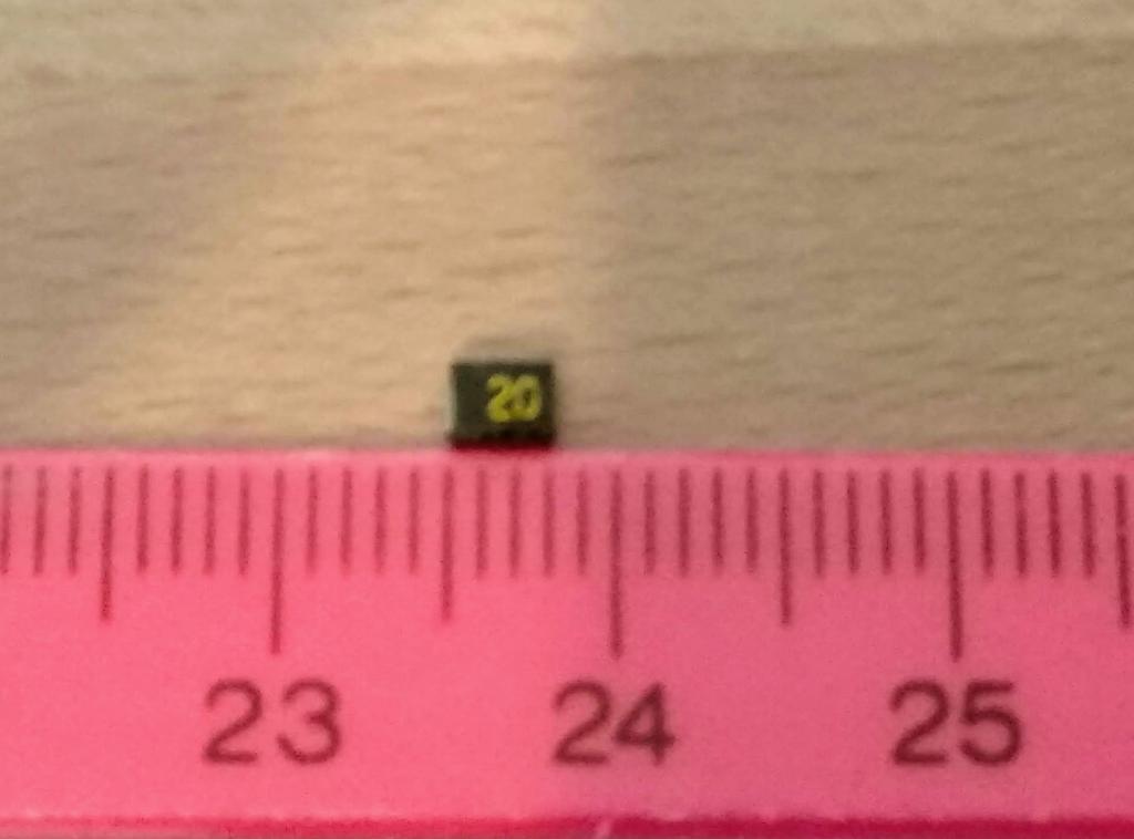

I'm currently tinkering with (read as "breaking even more like an unskilled chimpanzee") an Amstrad NC 100 notepad about which internal datasheets are somewhat sparse. I need to replace a blown 0.8 amp SMD fuse and I was wondering if anyone could point me in the correct direction of, or make an educated guess as to a suitable replacement - preferably one that I can get without buying in the 100's or paying 10x more in postage than the value of the part:
The fuse I've removed - which may not be the original (scale in cm/mm):

https://www.ebay.co.uk/itm/114763447921?hash=item1ab86f3e71:g:so8AAOSwsYpaLrCF
Basically any 1210 fuse of suitable rating or a 1206 fuse would do equally well
Edited 2021-05-05 20:17 by matherp

Thanks Peter, and I now know what the Voltage rating of a fuse is for ;-) - if this thing gets 72V from a 6V supply I think there are other problems.
In the real world does the difference between 0.8 A and 1.0 A not matter ?

  Quote  In the real world does the difference between 0.8 A and 1.0 A not matter ?
Not in my world but others may disagree - See https://www.youtube.com/watch?v=WG11rVcMOnY for more info on what fuse ratings really mean (or don't)

The fuse value is in most cases optimized to cover possible fault causes. Since the link shows photos from a low voltage dc power inlet, the value of 0.8A is also related to the original adapter provided. If you plan to repace the adapter with a switchmode brick that can supply more current, a value of 1A is perfectly fine.

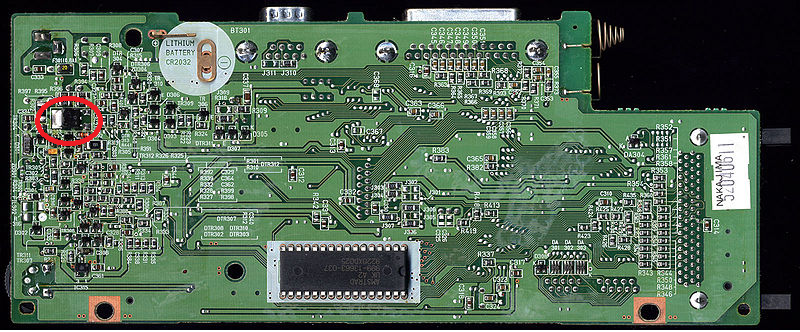

I've not been able to find a schematic drawing, but from the above I suspect that the supply is based around a little oscillator near the 6v input. I don't think it will be a simple regulator to 5v because of the age (it would be easy enough with a modern LDO). An oscillator of some sort would be needed for the -15v supply anyway.
https://www.cpcwiki.eu/index.php/A_surgical_guide_to_the_Amstrad_NC

So the circled device is not a 5V regulator (it has no writing on the visible side) ?
(low-res) images of the board can be found here https://www.cpcwiki.eu/index.php/NC_Series_Mainboard_Versions, I have the NA 999-32141 Board though the arrangement of the bodge on the top-side isn't (cosmetically) identical.

It may well be the 5v reg, Tom. If so it's almost certain to be a low drop out device as 1v drop isn't enough for anything like the 78xx series. Try powering it up at 6v with a 2.7R resistor (although I would prefer a 6v 2W or 4W bulb) in series and checking the pins of the reg to see what voltage is on them.
There is a group of four small electrolytics, C319-C322, on the other side. Given the age of the beastie it's worth at least checking those for any bulges. They *might* be a diode pump for the -15v supply but I'm only guessing. (your link to the pics also links to some higher resolution originals, which helps. :) )

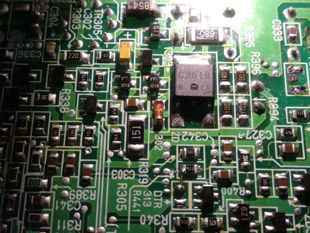

Posts: 4388
Posted: 10:16pm 07 May 2021
  thwill said  There is nothing written on the big 3 legged blob that looks like a regulator.
It turns out it was just filthy and a Q-tip and some IPA reveal it thus:
Posts: 11741
Posted: 06:52am 08 May 2021
2SC3518
