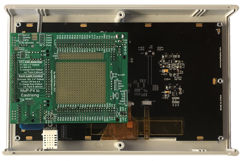

Hi All,
A fellow user, AndrewG, put me onto the F4 and I must say it is quite impressive.
Andrew also twisted my arm to buy a 9" Eastrising TFT and I am speechless.
All I can say is "wow what a combination"
Andrew showed me his collection of adapters and Vero board Prototypes and I thought that I can help him and possibly others here so I came up with MuP F4-Eastrising. Herein called F4-ER.
I think, rather than prattle on I will attach some pictures of the prototype and leave it up to anyone interested to ask questions or comment.
All modules are designed to mount on the bottom side of the PCB to allow the `stack' to be relatively thin.

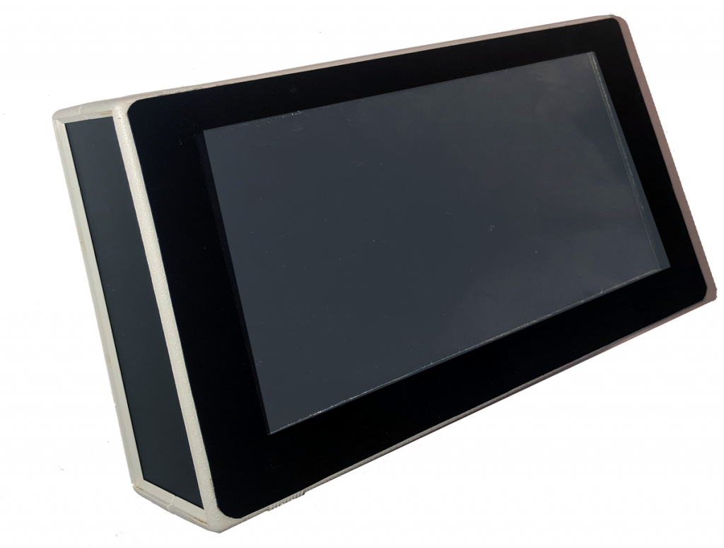

I chose a nice Hammond case that fits it perfectly (250mm x 160mm x 40mm external).

Attached to ER 9"
Case Closed
Any Comments or questions?

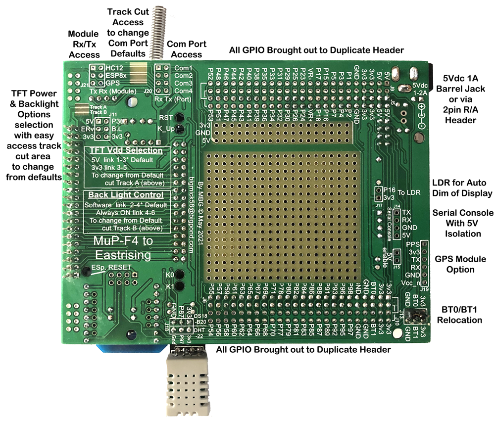

As is usual, there are a couple of minor issues with this first run.
The Main issue is 2 pads are erroneously connected to GND but I will drill these pads away and they will have no impact on the PCB. The rest is relatively minor.

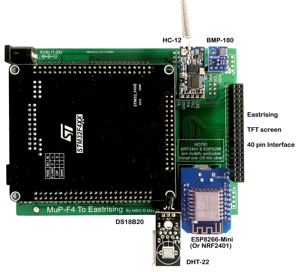

I have not really started on the manual at the moment, been taking pictures mostly.
Most sections have been tested and working OK.
We have just discovered that there is more than one pinout for the DHT22 and Andrew's and My modules have different layouts, I designed it to suit my layout..
Most people would want to mount the DHT22 away from the board anyway so it is only 3 wires and can be plugged up as required to suit your module.
Also I have the DHT pins in this board powered by 3v3 the next one will go to 5V as that is more in line with the specs, although many state that it works on 3v3.

Is the case stock or custom-made?

Thank You, and no module plugs directly to the F4 board, all modules connect to the 'MuP-F4-EastRising' PCB.
There should be no need to access the F4, the USB port and SD card are still accessible (with the rear of the case removed) and the mini switches are all reachable through holes drilled in my F4-ER PCB. If you look carefully in my first image you will see holes drilled for the 4 switches and the ESP reset button.
Even the 20way R/A header is accisble without removing the F4.
In fact it isnt so easy to actually remove the F4 as there are 2 x 48pin GPIO plus 32pin TFT header Plus 8pin NRF pass through plus 4pin serial console, a total of 140 pins (male/female sets) attaching the F4 to the F4-ER board.
I will look at the thread you mention on battery backup (do you have a link??) to see what that is all about, but that may be a user's choice.
As to switches as mentioned they are accessible and I have replicated the BT0/BT1 links so you can flash the F4 without removing it.
In practice some/most/all modules may be actually installed OFF board (ie externally) for example what is the use of a temperature reading of inside the case unless you actually wish to read the temp inside the case.

The case is available from Element14 >>> Case <<< and quite cheaply and it looks great.
I cut the hole with my dremel and the fascia is actually a thin black plastic cover from a folder that you often get with clear sleeves to insert A4/Letter sheets into. Readilly available and dirt cheap. And looks reasonably good.
