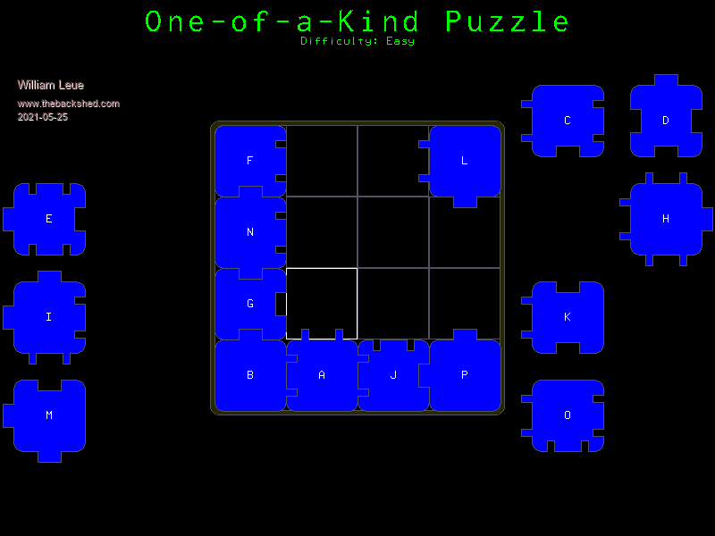

Here's a new program, the "16 Puzzle". Your task is to assemble the 16 pieces so that they fit into the square frame with no gaps or overlaps. You can choose from 4 levels of difficulty.
Enjoy!
-Bill

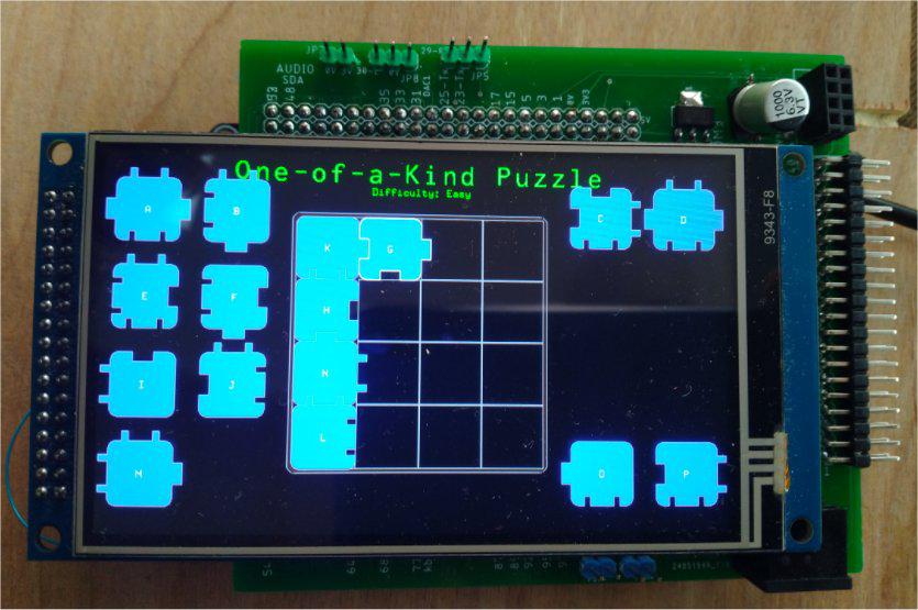

Nice. Also, for once, trivially easy to port to the Armmite F4.
While the CMM2 implementation can use a mouse, everything can also be controlled from the keyboard. But it was set up to use a plugged-in USB keyboard, not the PC console. So I replaced all instance of inkey$ with _inkey$(), and added this function:

This has the advantage of also allowing it to run on the CMM2 with PC console and VGA output to VGA-HDMI converter and HDMI-to-USB3 with Windows camera.
I did not run it through all its paces, so there may be something missing.

Thanks, Bill. This is a large and complex program you have provided--over 1200 lines. It's a tribute to your work and to the design and extension of MMBasic that by making a single change (replacement of a built-in function with a custom one on 10 lines) and adding 19 lines, it works on an entirely different hardware platform.
