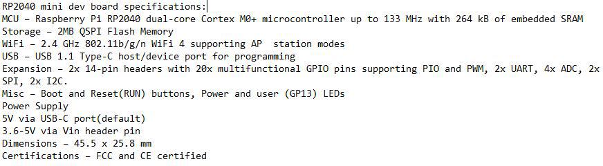

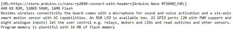

Posted: 12:42pm 27 May 2021
Is there any possibility later on for support for the versions with Wifi/Bluetooth already built into the board?
Seed Studio
Arduino Nano RP2040

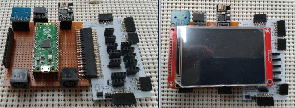

Posted: 01:27pm 27 May 2021
This looks excellent.
For the SPI LCD, will larger screens like the 3.5 inch SPI serial LCD screen module 480*320 TFT ILI9488 be supported? With, one hopes, LCD CONSOLE, no matter how frustratingly slow in scrolling?
I've seen mention in documents of a clock (other than the CPU clock speed), but no indication of an RTC (and of course, no built-in battery backup as far as I can tell). Are there special clock features which are built-in, or should one plan for an RTC battery or module?
Maybe even, with lots of flash available, optional built-in PS/2 mouse support on a couple of pins?
How did you get to 29 i/o pins instead of 26 (I note the 2x20 pi-type connector has 28 i/o pins)?
Is the pinout still a work in progress or can we have a peek? As far as pin numbering goes, I would favor CMM2-style, with perhaps "GPnn" or the like as an option.
Hope I'm not jumping the gun too much, but this is my vision:

@ Lew247
  lew247 said  Is there any possibility later on for support for the versions with Wifi/Bluetooth already built into the board?
I think Peter already answered that one:
  matherp said  The build is targetted at the standard Pico from Raspberry Pi.
@lizby: if you add SD card, real time clock....it is far cheaper to use an F4. You also get the faster parallel LCD.

  Volhout said  @lizby: if you add SD card, real time clock....it is far cheaper to use an F4. You also get the faster parallel LCD.
Right, but form factor difference, especially since the perfboard can be squeezed down for a PCB. And I'm not sure about "far" cheaper, since the micro SD module is about $1.50US and the RTC about $3US including shipping.

  Quote  Is there any possibility later on for support for
Not for the foreseeable - like all MM it is easy to use a ESP8266 for connectivity
  Quote  For the SPI LCD, will larger screens like the 3.5 inch SPI serial LCD screen module 480*320 TFT ILI9488 be supported? With, one hopes, LCD CONSOLE, no matter how frustratingly slow in scrolling?
Larger screens yes, console TBD, doesn't make much sense without keyboard support and this is intended for embedded use
  Quote  I've seen mention in documents of a clock (other than the CPU clock speed), but no indication of an RTC (and of course, no built-in battery backup as far as I can tell). Are there special clock features which are built-in, or should one plan for an RTC battery or module?
Will have normal MM time and date (main crystal derived), support for DS3231 possibly later
  Quote  Maybe even, with lots of flash available, optional built-in PS/2 mouse support on a couple of pins?
possibly later
  Quote  How did you get to 29 i/o pins instead of 26 (I note the 2x20 pi-type connector has 28 i/o pins)?
My error - 26 is correct
  Quote  Is the pinout still a work in progress or can we have a peek? As far as pin numbering goes, I would favor CMM2-style, with perhaps "GPnn" or the like as an option.
Will allow both

Incidentally, someone asked about bluetooth. Bluetooth and wifi don't exist on the Pico. There are add-ons for those, but there is no version of the Pico with either built-in - there is only the one version.
