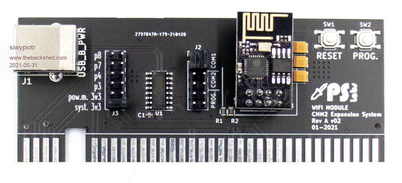

This card adds wifi functionality, includes USB to RS chip allowing easy flashing and communication with pc
Schematic can be found here: https://github.com/pslabs-ps/CMM2-ExpansionCard-WiFi/blob/main/Schematic/WiFi_REVA_v02.pdf

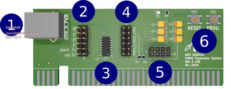

1. USB B connector for flashing ESP01 from PC
2. Power source selector
3. USB to UART converter
4. Port com and flashing selector
5. Socket for ESP01
6. Flashing buttons
