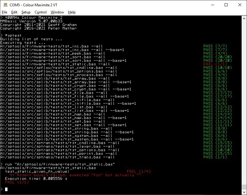

Given that the PicoMite has a file-system (or so I assume since it has SD support) could I request that you include * commands, OPTION SEARCH PATH, EXECUTE, and RUN with command line options as per the CMM2. This will allow my MMBasic unit-test suite to execute on it which is presumably advantageous to all ... except perhaps yourself given fixing any bugs it finds will ultimately fall to you.

  matherp said  Absolutely not and never - sorry
That's a shame, one command executed at the top-level runs every automated test I've written. Once you start unit-testing you never look back:
The FAIL is the known issue with STATIC variables that I've recently reported.
Anyway, thankyou for the PicoMite, it looks like a great piece of kit to release the magic smoke from whilst flashing LEDs, certainly cheaper than wrecking my CMM1 or 2.
