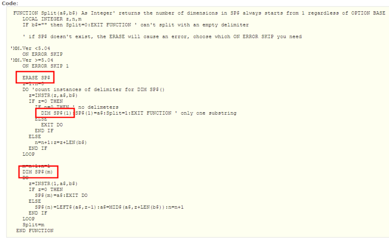

I use this with my VB-a-like Split function. Because an array cannot be REDIMed, I ERASE it then DIM it inside a Function expecting it to be available outside the Sub/Function.
In the red boxes, the array is ERASEd and then DIMed in one of two places. The new array becomes available outside the Function. This simulates the VB REDIM statement.
