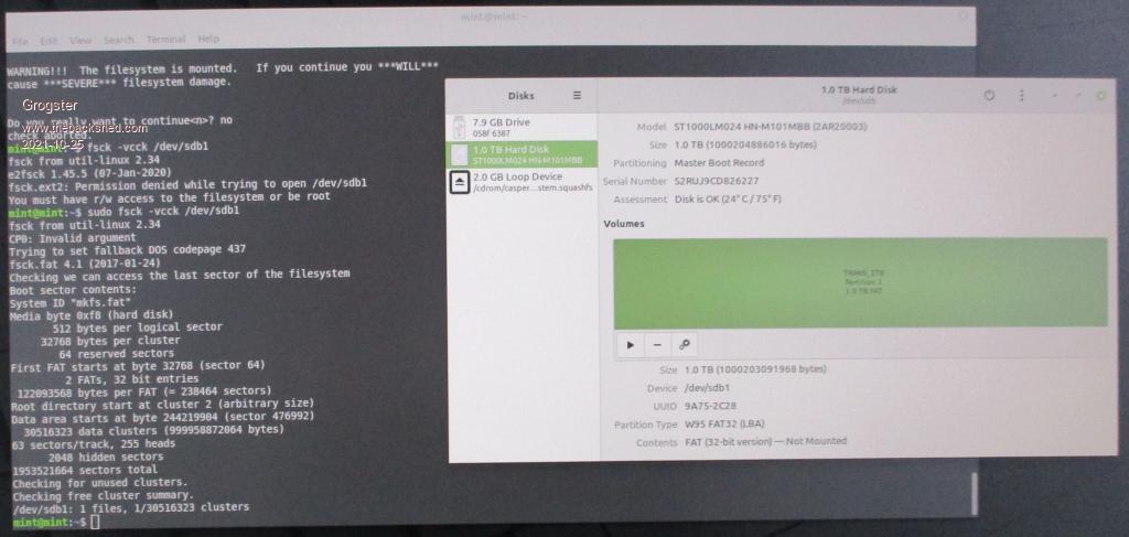

Howdy.
I have a 1TB USB3 drive which is suspect.
Every time I write to it, at about the 600GB mark, the write speed slows to 1MB per second instead of the usual 100MB or so per second for USB3.
Placing the drive up to my ear, I can hear that the heads are moving all over the place, so I think I have bad-sectors on this drive.
The problem is, with all newer OS's, they only seem to give you the choice of a quick-format, not a long one.  That is perfectly understandable given the size of the average modern HDD, but there are times - like this, when I need it.
Windoze DOES allow a long-format option by simply unticking the "Quick format" checkbox, but I want to use this USB drive in different systems, so I want to format it to FAT32, but Windoze won't let me do that - it is NTFS or exFAT - that's it.
Windoze won't allow me to format a 1TB drive as FAT32.
So, can someone point me in the direction of a Linux application that can do long-formatting?
I don't really care about how long it will take to do this - I will set it going and then go to bed and check on it the next day.  Whatever software would need to be able to identify bad sectors and mark them as such, and then just keep on going with the format.  You would end up with LESS then the full capacity, but that's fine.
This is only a drive I use to move files from one system to another, so I don't care about losing some capacity etc, only that it is compatible with all systems - which is why I am using FAT32, or wanting to, and WOULD slow-format it in Windoze if Windoze would let me, but it won't.

If you want to do a really long formatting/checking, run:
fsck -vcck /dev/device-PARTITION
This runs the `badblocks` utility, and will mark/remap bad sectors. This is in addition to SMART remapping. Really dedicated types will run badblocks for days over their new or suspect drives to ensure that SMART isn't hiding problems that will show up later.

Posts: 10008
Posted: 06:43am 25 Oct 2021
fsck seems happier then smartctl:
However, this completed in about three seconds.  Is it still running in the background?
scruss?
The activity LED on the 1TB USB3 drive blinks about once every ten seconds or so, so I am wondering if this is a backgrounded thing?

Posted: 02:45pm 25 Oct 2021
Not sure if badblocks runs on anything but ext filesystems. Looks like fsck.fat didn't even try.
ext4 is basically the same as ext2, but with journaling. ext2 tools used to be slow because, before SMART was everywhere, they assumed you had to check everything, Now many of the tools check SMART, see it's fine, and skip real checks.

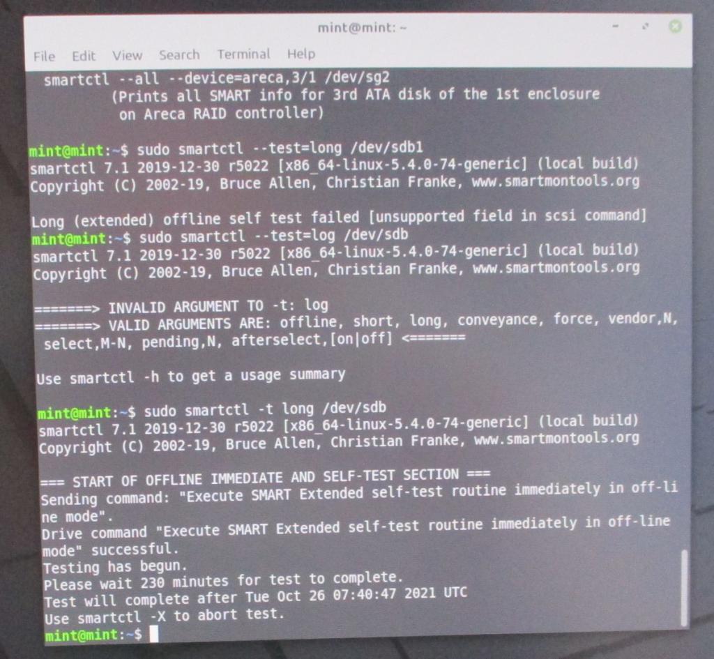

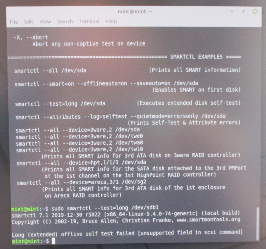

Posts: 10008
Posted: 11:34pm 25 Oct 2021
@ scruss: OK.
I've played with smartctl again, and it is now moaning about an unsupported field in the command, even when I use their own example from the help:
I have tried other variations of this, but they all report the same thing.  For example: smartctl -t long /dev/sdb1 as in the example in JohnS's post above, but that also generates the same error.
Posts: 3853
Posted: 01:37am 26 Oct 2021
I don't know all the circumstances, but does it need to be /dev/sdb instead of /dev/sdb1?
Posts: 10008
Posted: 03:51am 26 Oct 2021
Nice idea.  Mint assigns the drive the path of /dev/sdb1, so that is what I used, but I will try leaving off the number....
Bugger me!
You were quite right.
I was using the Mint path, as I thought that was what the path was or is.
Posts: 3348
Posted: 05:33am 26 Oct 2021
/dev/sdb1 is the partition path - allows fs checking only.
/dev/sdb is the disk hardware for bad sector checking.
