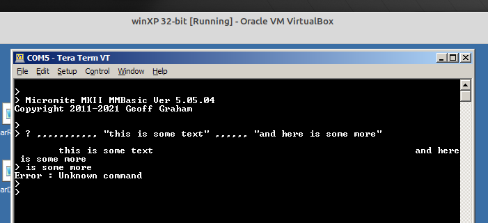

discovered on the picomite while testing out the new scrollback buffer, but also found to be present on the MX170 version of mmbasic:
> Micromite MKII MMBasic Ver 5.05.04
Copyright 2011-2021 Geoff Graham
> ? ,,,,,,,,,, "abc"
abc
> ? ,,,,,,,,,,, "def"
> ? ,,,,,,,,,,, "this is some text" ,,,,,, "and here is some more"
is some more
> print ,,,,,,,,,,, "this is some text" ,,,,,, "and here is some more"
is some more
it seems that 11 (or more) commas mess up printing at the command prompt. note that the behaviour is NOT present in a running program.

i suspect the bug may be related to the commas being expanded out into space characters, which are then somehow overflowing the print buffer.
here is it doing something even stranger, winXP (VM) and teraterm:
the printed output is overflowing into the input buffer.
the '>' ends up offset to the right. there definitely seems to be an initial trigger for the whole thing, but i'm struggling to find out what in any repeatable way.
