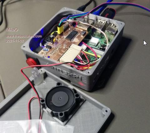

Just a quick post , after playing with Annex for quite some time I had forgotten how good mmbasic was and have used it for this latest project. Basically it is a Co processor for use with a raspberry pi , provides power control , shutdown / Restart for the pi , standby power is less than 10mA (could be uA if sleep was also employed) , pwm fan control. Communication with the Pi is via serial and  Node RED provides the interface. This also gives lots of scope to write routines in basic instead of scripts or Python on the Pi.

That's very neat, MikeO. :)
And a nice bit of shoehorn work to get everything in the box.
Posts: 6031
Posted: 09:08am 02 Nov 2021
Hi MikeO,
Nice IO board, solves some functions lacking in the pi.
Missing one thing though. The DS3132 RTC.....
And as Mixtel said....quit a squeeze to put it all in the small box...

I like that case, it's tiny! Is it 3D printed?

Yes 3D printed, designed to take a Pi4 plus DC to DC power supply .

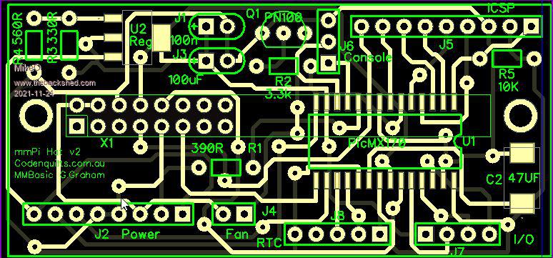

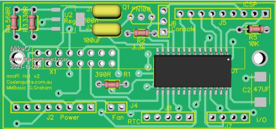

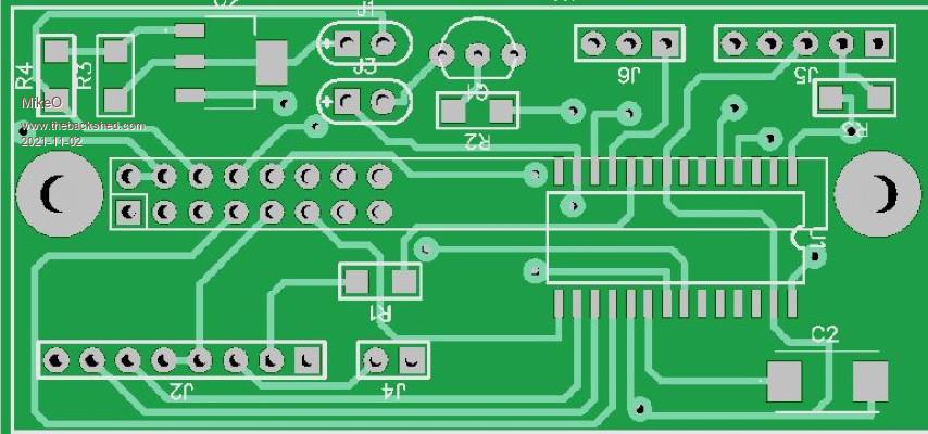

Joined: 11/09/2011
Posts: 275
Posted: 05:18am 24 Nov 2021
V2 PCB now complete. Makes all unused mx170 pins available and adds a RTC connector.
This board makes all ADC pins available to the Raspberry Pi (via Node red suggested).

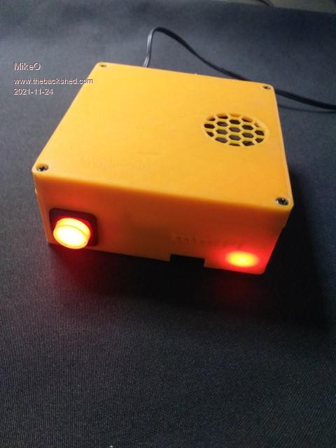

New enclosure
Long press of Button starts shutdown sequence, Pi Red power Led will go out when shutdown complete and RPI will be powered down. Standby current is ~ 6mA. Longpress again will restart the Raspberry Pi.
