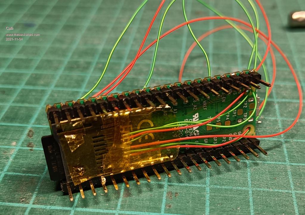

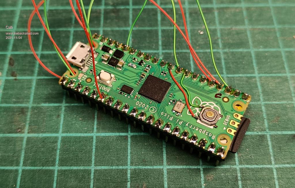

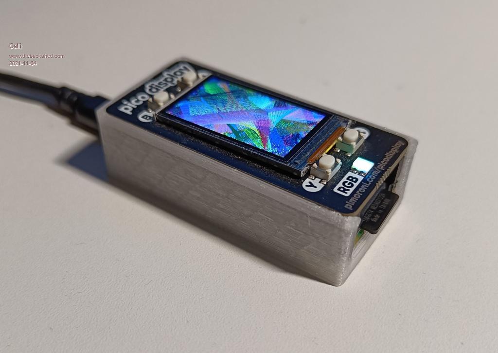

I bodged a uSD-Slot onto a Pico which carries a Picodisplay.
Super cute little device with four switches and a RGB-led.
I use these options:
OPTION SDCARD GP22
OPTION SYSTEM SPI GP18,GP19,GP4
OPTION LCDPANEL ST7789_135, LANDSCAPE,GP16,GP2,GP17
The wires were shortened after a first test! Yes that's a reset-switch.
Best,
Carsten
