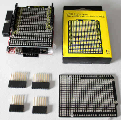

Posts: 9027
Posted: 08:45pm 04 Nov 2021
So make one...  :)
You could probably just drop a PicoMite into the space between the Uno connectors on a Proto Shield with a bit of creative copper carving and some wire links. You'd be 3 analogue ports short, of course.
I've just been looking at a similar  shield and it looks pretty easy to do, soldering the PicoMite directly to pads underneath the shield. Would probably have to drill some away where the pads are underneath the Pico though.
Edited 2021-11-05 06:53 by Mixtel90
Poppy
Joined: 25/07/2019
Posts: 486
Posted: 09:12pm 04 Nov 2021
I use those from Keystudio ... for my Duinomites.
Andre ... such a GURU?
Posts: 9027
Posted: 09:27pm 04 Nov 2021
Those would probably be better, Poppy. There's less clutter on them.
Poppy
Joined: 25/07/2019
Posts: 486
Posted: 07:22am 05 Nov 2021
  Mixtel90 said  Those would probably be better, Poppy. There's less clutter on them.
Exactly, that is why I simply prefer these.
