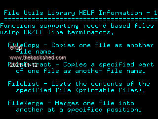

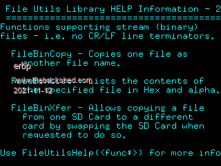

The following shows the general Help information available via the FileUtilsHelp() function. These list the remaining 7 functions (apart from Help) that the library provides.

The remaining 3 functions are for use with stream (non-record based) files - i.e. files that are a stream of bytes and do not use any record structure. These files are sometimes referred to as Binary files or Non-Text files and typically contain some/many byte values which are not printable characters. Bitmap images are an example of this type of file. However record based files can also be treated as stream files, so these functions CAN be used with record based files, including files containing records longer than 255 characters.
I am using the 'Bin' (binary) abbreviation to identify these functions. The 3 functions supported are:-
FileBinCopy - provides equivalent functionality to the FileCopy function, except that it can handle both stream files AND record based files. Using FileBinCopy will allow a record based file with record size greater than 255 characters to be successfully copied. See FileUtilsHelp("FileBinCopy") for syntax and a brief explanation of this function. Following is an example of using the FileBinCopy function.
FileBinList - lists the content of a specified file (stream or record based). The listing output is formatted as two lines displaying 10 bytes of file content. The first line displays the printable character for any bytes with values between 32 and 126, other values will display as a blank on this line. The second line displays the Hexadecimal value for each byte regardless of whether it is a printable character or not. Unfortunately this only allows 80 bytes of file data to be displayed per console "screen", so is very limited when listing larger files. See FileUtilsHelp("FileBinList") for syntax and a brief explanation of this function. Following is an example of using the FileBinList function.
FileBinXfer - allows a file (stream or record based) to be copied from one SD Card to a different SD Card. This is achieved via a 2 step process. Firstly, the content of the file is copied into a data array resident in RAM. The function then displays instructions to the user to swap the SD Card to the one that the file is to be copied onto. Once this has been done and confirmed by entering OK, the required directory structure will be built on the second SD Card (if it doesn't already exist), and then the file data copied from the array in RAM to the second SD Card. Due to size constraints on the amount of RAM available for the array, this function is limited to a maximum filesize of 100200 bytes (approx 100KB).  See FileUtilsHelp("FileBinXfer") for syntax and a brief explanation of this function. Following is an example of using the FileBinXfer function.

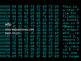

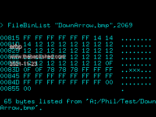

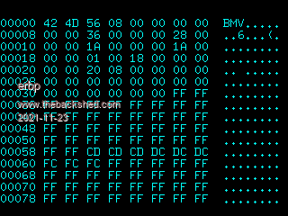

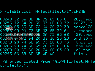

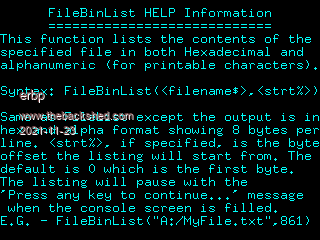

Here is an update to the FileUtils library that I posted back on 12 Nov 2021. This is Version 1.0.3 (the version is shown on line 3 of the source listing) and includes an updated FileBinList function implementing the suggestions made by @Mixtel90 (Thanks Mick).
There are 2 changes compared to the original version of this function:-
1. The output is formatted differently which allows 128 bytes from the file per console screen to be displayed in Hex and printable characters in Alpha with non-printable chars shown as a period (.) in the Alpha section. This compares to only 70 bytes per screen in the original. Also the format is more readable and I suspect many will already be familiar it - see example screen images below.
2. The FileBinList syntax has been changed to add an optional Starting Byte Offset, so that you can select the starting position within the file that you wish to start listing from. Note that this is an Offset value so is zero based and may be specified as a decimal value or in hexadecimal using the &H prefix. The default if this argument is not specified is zero, so the listing will start from the first byte in the file. There is an updated Help page for the FileBinList function to show the changed syntax - example screen image also shown below.
FileBinList Output examples - Stream File
FileBinList Output examples - Record Based File
Updated Help Information for FileBinList
