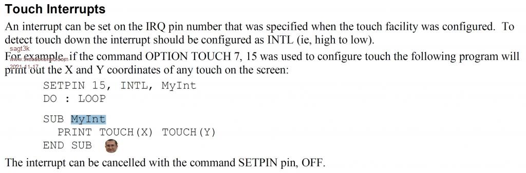

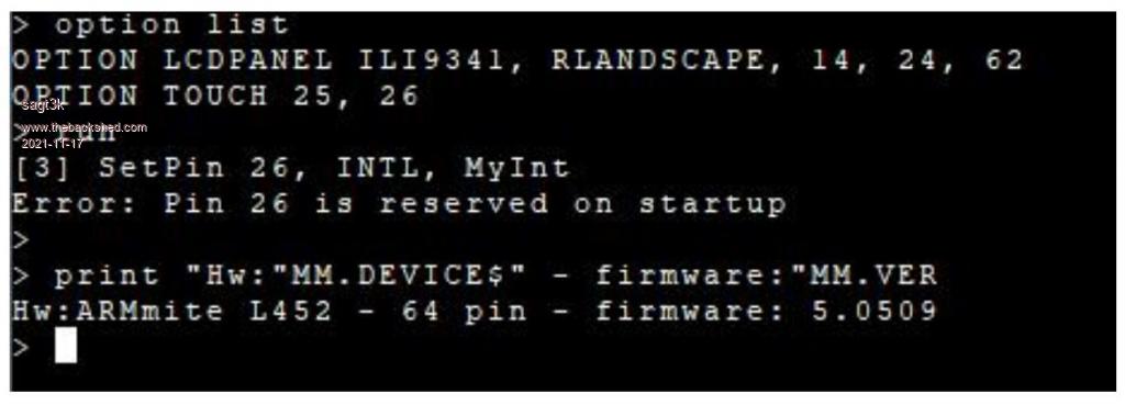

I use NUCLEO-L452 with the MMBASIC ver. 5.5.9, and I have problem to manage touch functions, when I set int on intq pin, I have the follow problem;
I ask to you to solve the problem, Is There a new version for STM32L452 updated?
Can You share the link or suggest the solutions ?
Antonio
Posts: 7889
Posted: 10:13am 17 Nov 2021
If pin 26 is used for touch detection it's already taken so you can't then use it for your own interrupt. That's why you are getting the "reserved" error.

I follow this original example :
For STM32, have you a suggestion to manage LCD+TOUCH+IRQ(TOUCH) ?

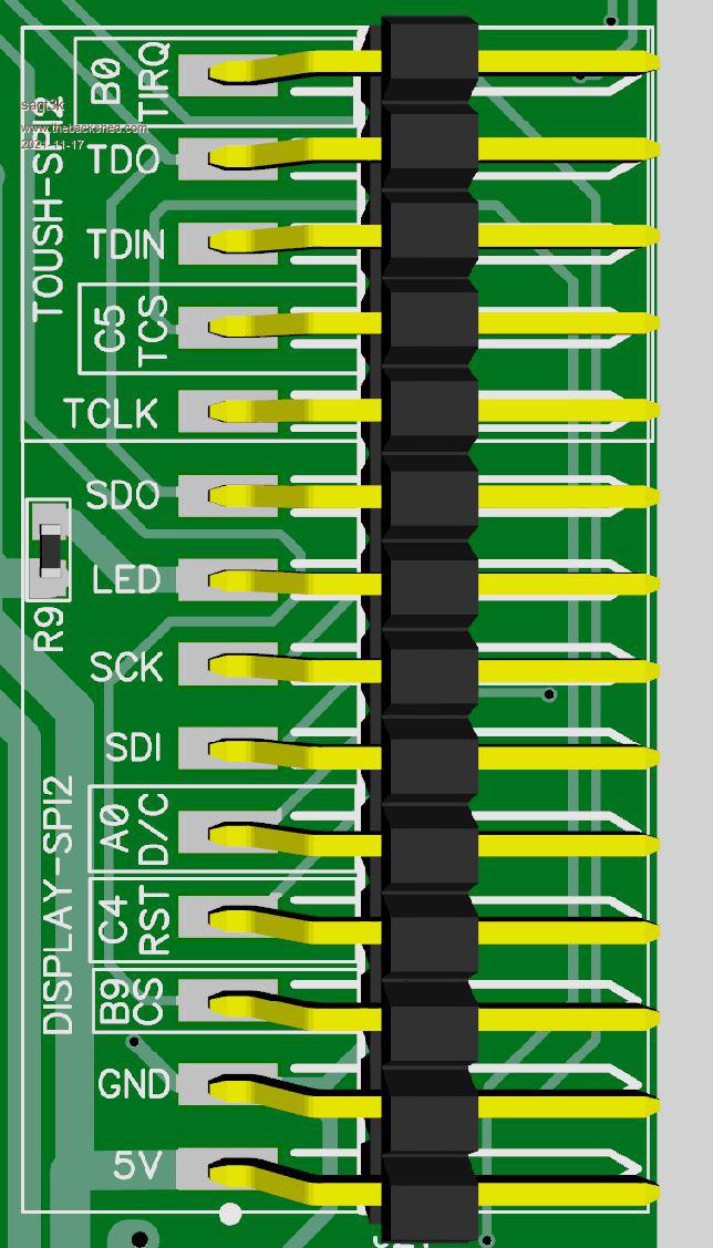

This is my PCB for connect ILI9341.
Thanks for you suggestions

Posts: 10273
Posted: 11:23am 17 Nov 2021
That functionality isn't enabled on the ArmmiteL4. Easy workaround is to test touch with a settick interrupt
