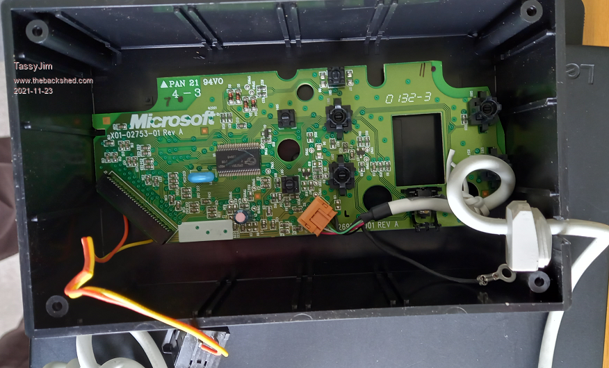

Posts: 6271
Posted: 09:25pm 22 Nov 2021
A few years ago I had a desire to send a small string to a PC so I butchered a keyboard and used the keyboard IC to do the heavy lifting.
I just traced the circuit board to find out which pins needed shorting for the desired keys. One incarnation used a micromite to 'hit' the keys in the right sequence.
This version has a simple pushbutton.
Posts: 2626
Posted: 11:44pm 22 Nov 2021
@TassyJim
That is clever. Perhaps you don't need to butcher the keyboard. Run a ribbon cable in the back to the desired PCB tracks making it dual purpose.

Posts: 7889
Posted: 08:44am 23 Nov 2021
Be careful, Stefan. A keyboard will be multiplexed so you can't use a common power supply for the Pico and the keyboard unless you use something like a CMOS switch to isolate the Pico output pin from the row + column of the keyboard matrix.
