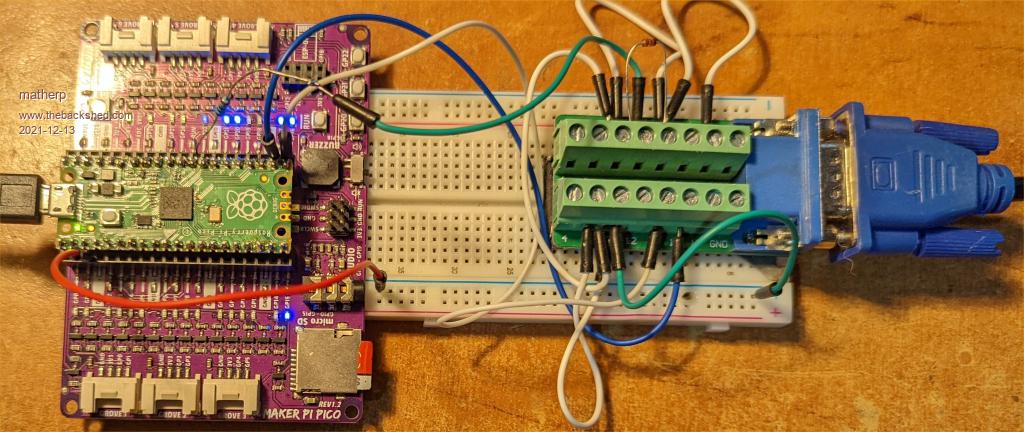

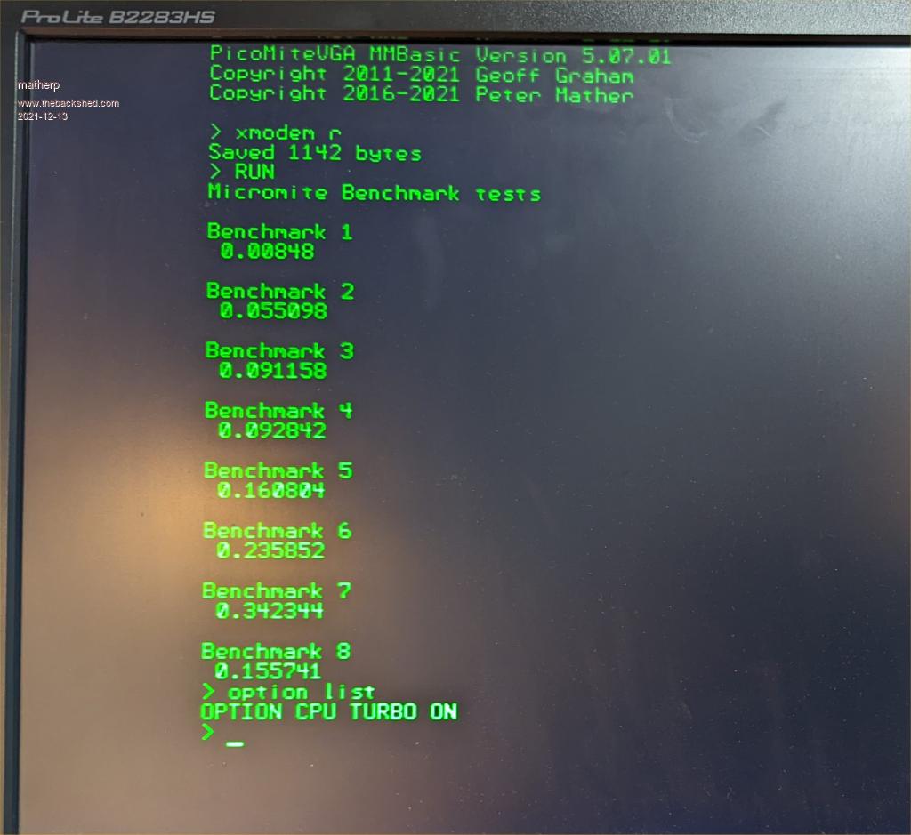

Was this not supposed to be "impossible", or at the very least too resource consuming ?

LOL! Nice one Peter. :)
Even cheaper than the BP too...

*colour* VGA might cause a problem, but there's only one bitplane here. I think it's *very slightly* slower than the VGAmite too, but I don't know the clock speed.

Isn't OPTION CPU LIGHTSPEED implemented yet?  ;)

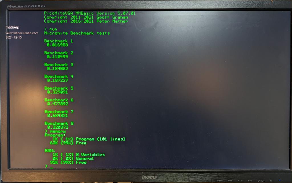

This is seriously encouraging. To get those benchmarks with a VGA driver running at the same time is really neat.

Just tidying it up and getting PS2 keyboard working then will release a version.
This will be a VGA only version - no support for any other displays and no GUI/TOUCH support (makes no sense on a monochrome display).
CPU runs at either 126MHZ (normal) or 252MHX (turbo). Also PIO0 is not available for use.
Other than that it will have all the other PicoMite functionality.
The only compromise is that the display has to be blanked when writing to flash as this can only happen with interrupts disabled. How fast the image returns depends on how fast your monitor re-establishes lock.
This happens when exiting edit, exiting autosave, changing options, using VAR SAVE or using FLASH commands that write to flash. Otherwise the mage seems very stable and clear.

I was lying in bed this morning wondering if you were using a PIO to get the syncs, with an interrupt to trigger the CPU to squirt pixels out. :)

  Quote  I was lying in bed this morning wondering if you were using a PIO to get the syncs, with an interrupt to trigger the CPU to squirt pixels out. :)
As usual not my original work but I am good at incorporating, modifying and extending the work of others
See here for full details of how it works and Miroslav Nemecek who did the real clever stuff

Looks you are running native 640x480 resolution, not the QVGA 320x240.
So you modified for monochrome, and clocked at 252MHz, and reserved 38k for video memory ?
Leaving an impressive 210k RAM for basic ? (effective 65k editor, 65k variables, 65k program ?)
