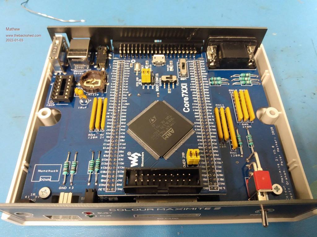

I was given a kit to build a Colour Maximite 2 and been having fun, but I seen to be stuck.
It is a v3 motherboard by Geoff Graham and Peter Mather, which uses resistor arrays. The kit came with 220 ohm arrays instead of 240 ohm ones, so I ordered some 240 ohm ones from eBay.
I am an experienced solderer, so I think I soldered everything correctly. Here are some pictures. It's in this state right now except I also populated the 14 point in socket in the top left.
I uploaded the 5.07 firmware I found online (with jumpers removed like the instruction said), put the jumpers back on, plugged the power and monitor in and turned it on. The power light comes on, but there is no output to the monitor.
Help would be appreciated.

You need a battery fitted and all the jumpers removed from the waveshare module. Alternatively, no battery and just the VBAT jumper.

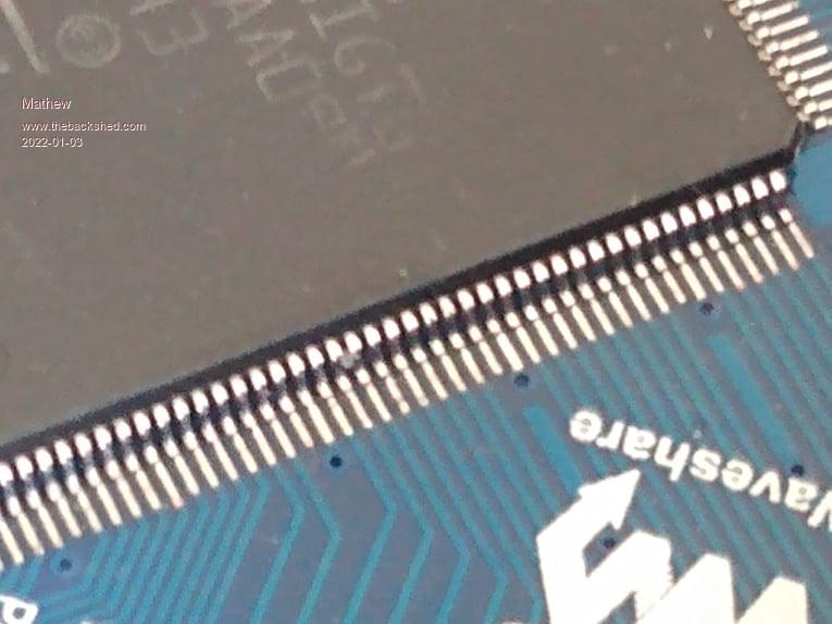

Looking at the waveshare, I notice what looks like a short between two legs of the main chip. This has me worried.
Posts: 9136
Posted: 03:35pm 02 Jan 2022
Will that bit of something shift with the aid of a pin or something? From your photo it doesn't look like solder.

Posted: 03:47pm 02 Jan 2022
For running
Boot Switch to flash
power switch to 5Vin
all jumpers removed except VBat if no battery fitted.
This is all in the constructors pack on Geoff's site

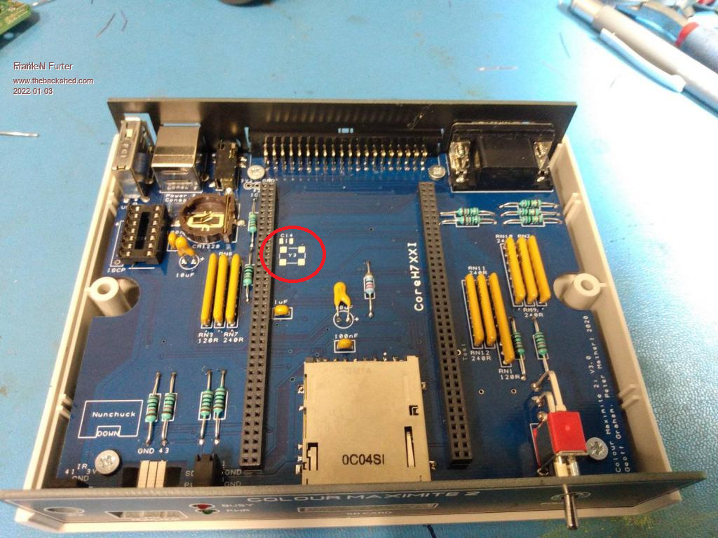

...stupid question: Am I the only one who misses the oscillator???
From "CMM2_G1_Construction Guide.pdf":
External Oscillator
The latest PCB has provision for an external 8 MHz crystal oscillator to replace the 8 MHz crystal on the Waveshare CPU board. This may be needed in some rare cases where a monitor has difficulty with some VGA modes (such as 800x600 pixel 16-bit colour).
Most people will not need this modification however, if it is required, it can be implemented by installing the external oscillator and a capacitor on the motherboard (under the Waveshare CPU board). The 8MHz crystal on the Waveshare board does not have to be removed.
The parts required are:
1 SMD 1206 100nF ceramic capacitor
1 8MHz oscillator in 5.0 x 7.0 mm SMD package (QX7 XO 25ppm). Eg, RS Stock Nbr 813-6194.

Yes, I use the oscillator mod. I couldn't get some of the modes to work until I fitted it. The problem only seem to be with some Waveshare modules, I was one of the unlucky ones.

The chip is clean and every test I do says it's fine but when I plug it in there's no display on the monitor.

I am concerned about the solder short on the wave share, you need to remove that, use solder wick and a hot iron but do not over heat the joints, if not moving, which it should. You could revert to a sharp scalpel but solder wick works well especially with some added flux.

I just noticed I have a Core7XXI, but the BOM calls for a CoreH7XXI. Could that be the reason it's not working?
Edit:
I just pulled up the specs of the boards and they are very different. The non H core is 216mhz, and 1mb flash. The H core is 480mhz and 2mb flash, for instance!

Posted: 12:01am 13 Jan 2022
Oh!
That'll be the issue, I expect.
