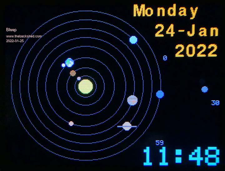

I subsequently shrunk everything using a Pimoroni LCD Display 2 This is a very neat and sharp display, which simply plugs directly on to the pins of a Pico, so making it very compact, I also added a DS3231 RTC so you don't have to set the date/time every time, next will be a box.
I have also now added the bouncing Pluto, seconds display, very roughly the height Pluto bounces, is approximately seconds counting down to the next minute, the display animation of Pluto updates at about 10Hz, so is fairly smooth.

I have now added the Moons orbit around Earth.
I have also added an option flag, if you do or do not have an RTC attached, set rtcl=1 or 0 in the variable initialisation; obviously you will need to set time and date every time you loose power, without the RTC, but it still keeps reasonably good time.
Otherwise everything else is as before, hopefully.
I've used this RTC https://www.ebay.co.uk/itm/154736489893 ... Sw~~ZhrlGc and this SD card module for loading and saving files too/from the Pico https://www.ebay.co.uk/itm/193453320566 ... Sw3lZeyOFY they both work fine. The solarsys.zip file has been updated, see below, with the latest 2 versions of the program, standard and the Pimironi display, along with the MMBasic Options I set.

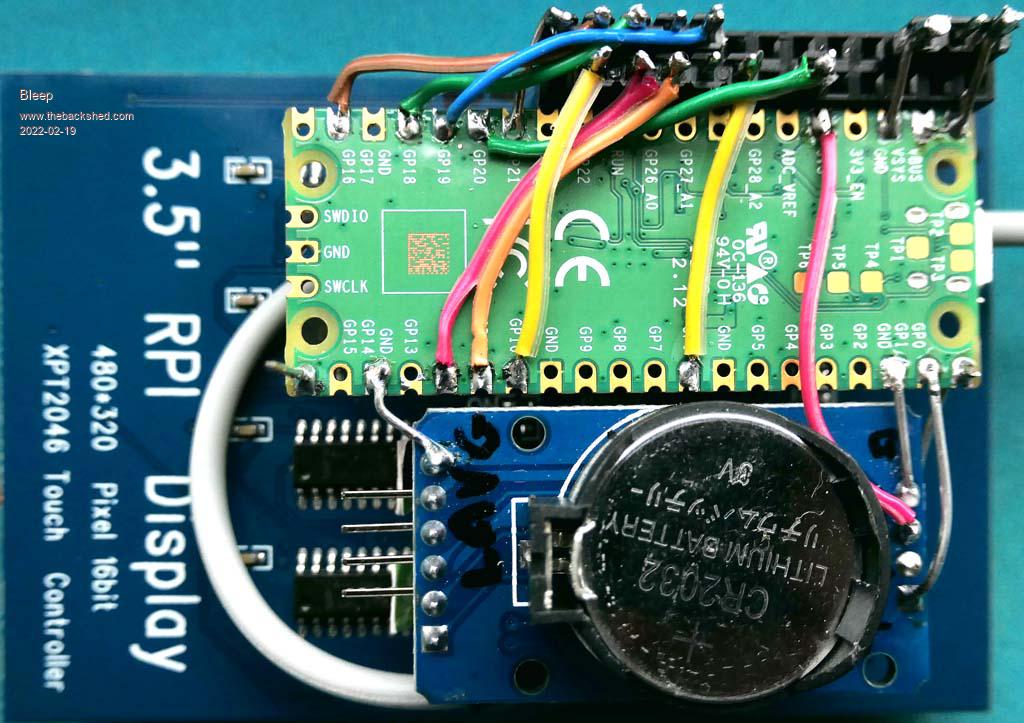

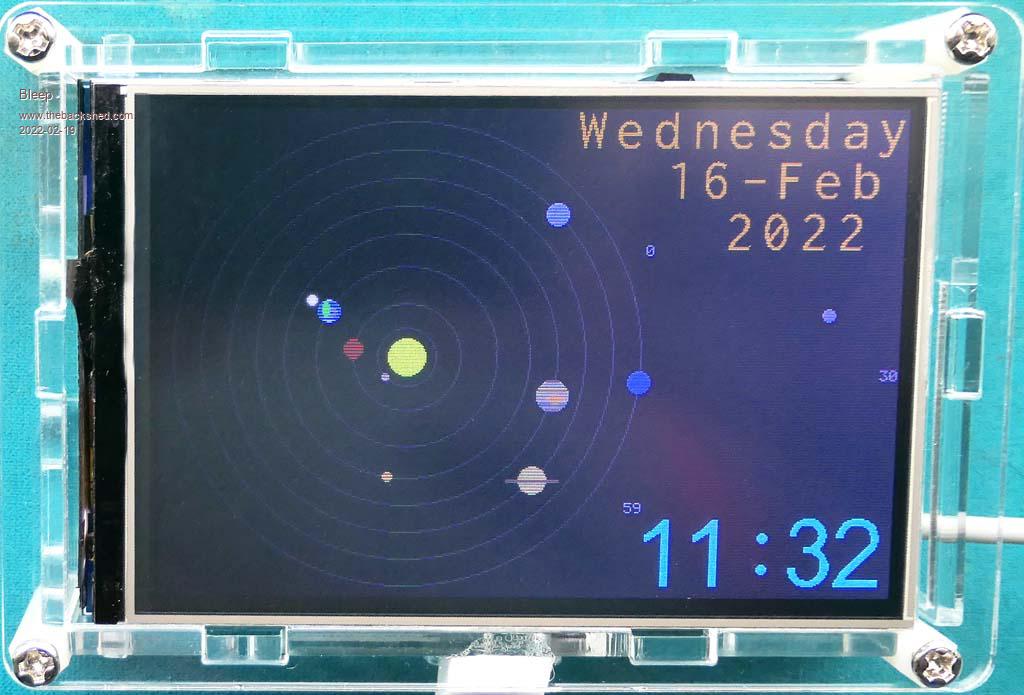

Finished 3.5" Raspberry Pi touch display, attached to a Pico, & RTC, in a perspex case that came with the display, Display on Ebay.
Many thanks to Peter for PicoMite and pointing me in the correct direction for connecting the diplay and the fact that even though it was a ILI9486, the PicoMite  ILI9481 driver worked fine, which it does. :-)  Because I got the back screen brightness working I have also done automatic brightness, depending on time of year and time of day, it can be overriden with the touch screen brightness control.
Thanks to all involved,
Regards, Kevin.
