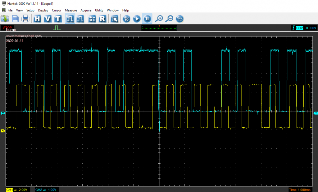

Hello matherp (Peter Mather) and Geoffg (Geoff Graham),
Over the weekend I spent a lot of time with Picomite and learned a lot.
First of all, I dealt with the interrupts.
I wanted to use this to read a Manchester code from an rfid chip of the EM4095.
https://en.wikipedia.org/wiki/Manchester_code
I found out that my interrupt routine is just too long or too slow.
That's why I have already defined fixed timings, in order not to lose even more time through calculations.
I tried to use the following listing:
'rfid reader - by mikroelektronika EM4095
SetPin gp25, dout ' interne LED
Pin(gp25)=0       ' LED aus
SetPin gp12, din  ' OUT
SetPin gp13, din  ' RDY/CLK
SetPin gp14, dout ' MOD
SetPin gp15, dout ' SHD
SetPin gp16, dout ' test pin oscilloscope
Pin(gp16)=0
Pin(gp14)=1
Pin(gp15)=1
Pause 750
Pin(gp14)=0
Pin(gp15)=0
old_timer=0
diff=0
timebase     =0.384 ' 1 Bit ~ 512 mikrosec. ~x0.75 bzw. 1.25
timebase2    =0.192
bitstate=0
bit=0
Timer =0
SetPin gp12, intb, rfOut
Sub rfOut
 diff=Timer-old_timer
 old_timer=Timer
 pinstate=Pin(gp12)
 If (diff > timebase ) Then
   'this is a long pulse after a short pulse
   bitstate=0
 Else
   If (diff < timebase2 ) Then
   'this is a short pulse after a long pulse
   bitstate=1
   Exit Sub
   Else
     'same pulse length (within 0.75x and < 1.5x of last length)5
     If (bitstate=1) Then
       ' even number of consecutive short times at this place
       bitstate=2
     Else
       If (bitstate=2) Then
         ' odd number of short times at this place
         bitstate=1
         Exit Sub
       EndIf
     EndIf
   EndIf
 EndIf
 ' timebase = 3 * diff / 2    'to slow?
 If (bitstate <> 1) Then
   If pinstate=0 Then bit=1 Else bit=0
   'Pin(gp25)=bit
    Pin(gp16)=bit           'debug pin
 EndIf
End Sub
Print "Los gehts im Dauerloop ..."
But in the picture of the oscilloscope you can see that I miss more interrupts on edges of the signal.
And this although the CPUSPEED is set to 250MHz.
Yellow is the Manchester code, blue the wrong bits (sometimes).
Now there are several points (questions or wishes):
1.) A generic routine for the decoding of Manchestercode (with self-learning time base) as a command with interrupt that always happens when a bit is ready, then one could do the decoding etc. for the protocol in Basic itself. (Dream wish :-) !) How can I persuade you or you Peter (matherp) to do this? ;-) - This can be used for many different things: RFID transponders, time code, SPDIF, propeller clocks, and much more.
or
2.) I would try to program the function myself in C and then create my own command. But I would have to be able to create the .uf2 file myself. This would be generally helpful!
2b.) Is there a step by step guide on how to compile the source code to create said .uf2 file? Or can someone explain this please?
Or
4.) Or is my assumption or the timing problem unfounded and I am just clumsy? And the whole thing could be solved directly in Basic?
or
5.) Or could the PIO be used for this? But I don't have the idea or the understanding, so I would need help from the forum. Does anyone want to help?
Thank you for your comments.
Matthias

I wouldn't normally throw this out because I can't tell what kind of performance improvement is required and I am away from my MM stuff so I can't experiment but:
1) I remember someone realising a significant speed-up by shortening the variable names (I don't know if this still applies)
2) On a different processor, I was using 3 single-precision variables and for giggles I replaced them with integers, using shl and shr jiggery-pokery to preserve precision....this boosted my loop speed by a factor of 5(!!!)
Posts: 10052
Posted: 05:21am 12 Jan 2022
Interrupts should be AS SHORT AS POSSIBLE.
I know it's tempting to put all the code you want inside the interrupt sub, but that is a bad idea, cos if another interrupt is triggered while the code is already inside the interrupt, bad things can happen.
Set flags only in the interrupt, or at MOST read the data, then exit the interrupt.
Have your main loop examine the flags and decide what to do, or process the data - or a combination of both.
Not saying this is the cause of your problems, but you should NOT put the processing code for the interrupt, inside the interrupt itself.
From the coding bible: "Thou shalt not hang around in interrupts."

Posts: 6620
Posted: 02:20am 13 Jan 2022
The PICO manual suggest that ADC command can sample a single channel at 500kHz.
That should be plenty fast enough.
Provided the data is coming in batches and not continuous, using ADC to do the sample then whatever is needed to analyze and display.
A lot of the current offerings have the ADC command.
