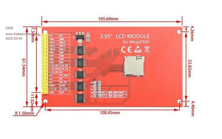

I have a question in same topic:
My SPI display ILI9488 works with no issue, but I bought this ILI9488 3.95" display and I don't know how to connect to Picomite. Any advice?
Thank you

It has an 8 bit parallel interface and I don't think it will work.

On my Arduino setup I think I used just 4 low bits and SPI

Palcal you are right, this is 8 bit parallel interface, so there is no driver for it?
Posts: 3411
Posted: 04:46am 04 Feb 2022
The only parallel one listed in the manual (p45) is SSD1963.
