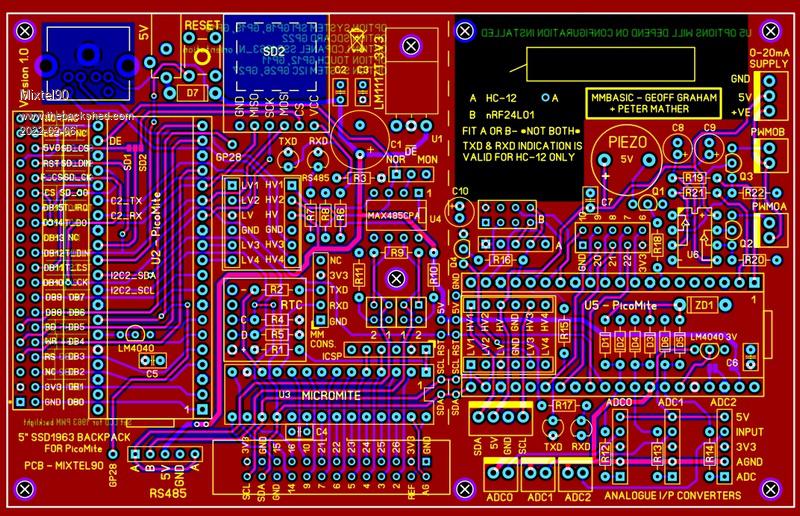

Well... yeah... it's a "Topsy" board.
It started off with the RS485 version of the SSD1963 adapter. The problem with all those is that of stability - there are no fixing points in the midddle. I've put a hole over a blank-ish area of the display pcb so something like a rubber foot or nylon spacer can be fitted there, but it doesn't stop the adapter swinging backwards - it's depending purely on two corner holes of the display. The answer is to make it a full size board. But what do you do with all that empty space?

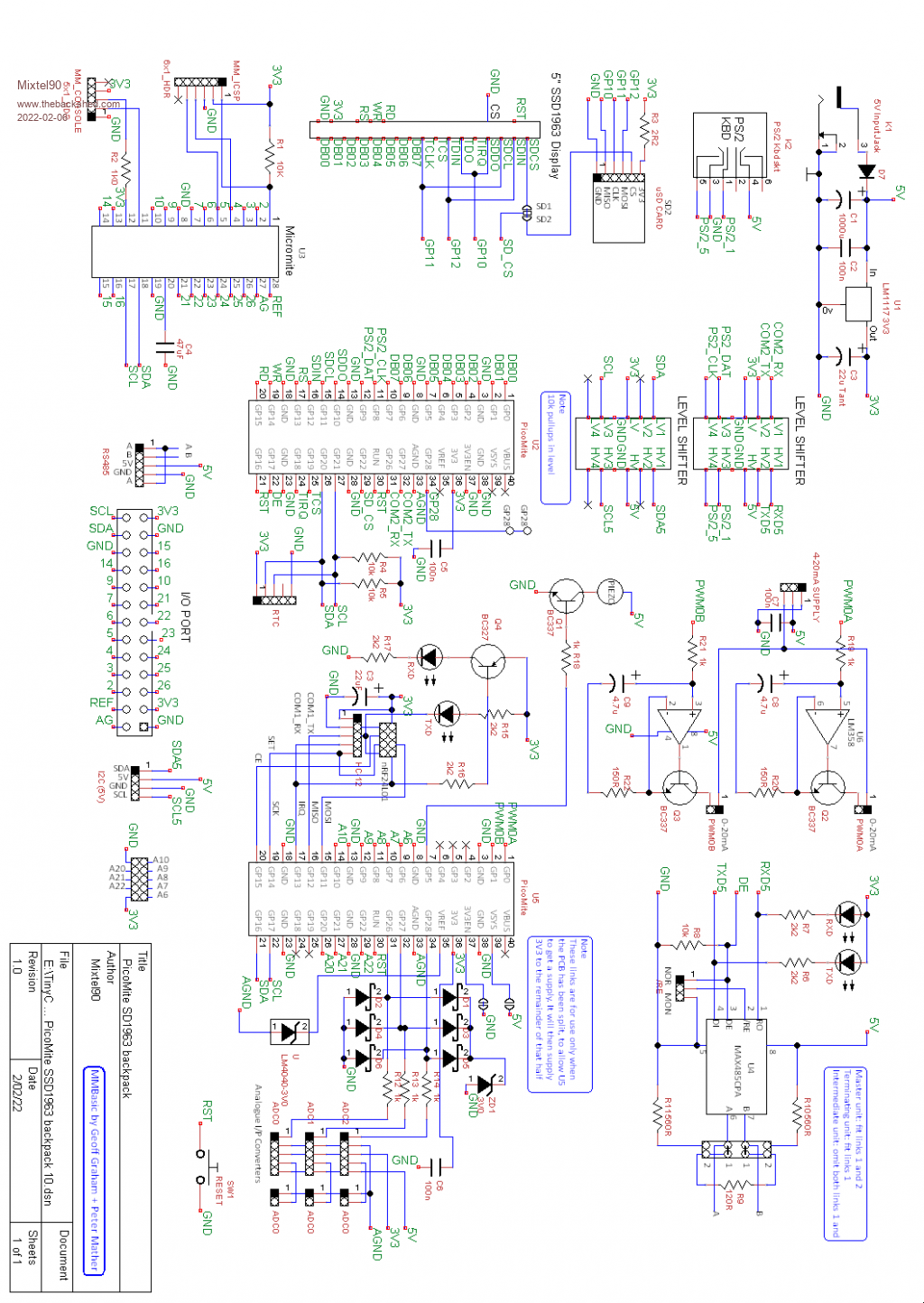

The PicoMite has very few pins left when it's connected to the SSD1963. I'd used 3 for the RS485 COM port and 2 for the I2C with the RTC and Micromite on it. That only leaves 1. So it has to be something on the I2C bus. Why not another PicoMite?
*  You could give that the slog of the wireless stuff to handle and just get yes/no and status messages to/from the main PicoMite. That opens up the possibility of using the nRFL2401 which needs a fair bit of code but runs its own network. This module deserves more attention anyway.
*  So, while we're at it, we have 3 12-bit analogue inputs. Make them convertible so any value of potential divider or current shunt or even amplifier can be used.
*  A couple of PWM outputs can be used. We can accept current inputs now, so make them 0-20mA current outputs, which are used a lot for industrial control.
*  a buzzer would be nice, especially with a touch-screen. :)
*  We are using the RS485 version as a base, so we haven't got the 5V I2C. It only needs a level shifter so tuck that away underneath the PicoMite. :)
So basically you have a 3-processor system linked over I2C. You can do whatever you like with that. :)  Bits you don't like or need can simply be left off - very little is interdependent.
After all that, make the board splittable. The RS485 half is more or less as before. Just a couple of tracks extended. The new half has no regulator, but a couple of links allows you to feed it with 5V and switch the PicoMite SMPS back on.
There are spare pins that I've not managed to route out. I've not managed to fit open loop detection in on the 0-20mA current loops (or make them high level sourced :( ). I couldn't get stereo sound as that would need more pins on the main PicoMite. However, if someone wanted to sacrifice the RS-485 it could be done with some fiddling and a piggyback board, I suppose.

Very nice "Tight" layout.
You've got the hang of Sprint Layout now, haven't you!

Something I did that may be useful: I did a macro of just the PicoMite GP numbers in tiny text and a pad on pin 1 for location. I can put that on the board with a normal macro overlapping in the same position. Once I've finished, just delete the pin numbers macro and they all disappear like magic. It can also be put back very easily, of course.

You did it, you created a E100 (micromite extreme 100) in recent silicon.

I can see it being a great toy though... All three 'mites can be doing their own thing at the same time, synchronising over I2C. If you connect it to chained I2C expander modules and connect the IRQ line to GP28 you can get more 'mites joining in the fun. lol
